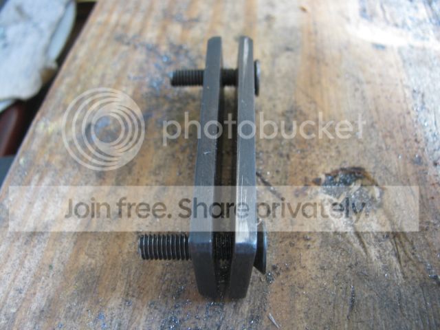

Here is my file guide:
Two pieces of hardened 1084 attached with two flat head bolts.
One is drilled with a #21 tap drill and tapped 10-32...
And the other is drilled with a #5 tap drill and countersunk.
Bolted together with 2 of these (there's only one in the photo though)
Attached to the knife like so...
Before I hardened the steel I bolted them together and evened the edges with a file and sandpaper.
Hope this helps! :D Good luck in your knife making adventure! :thumbup:
