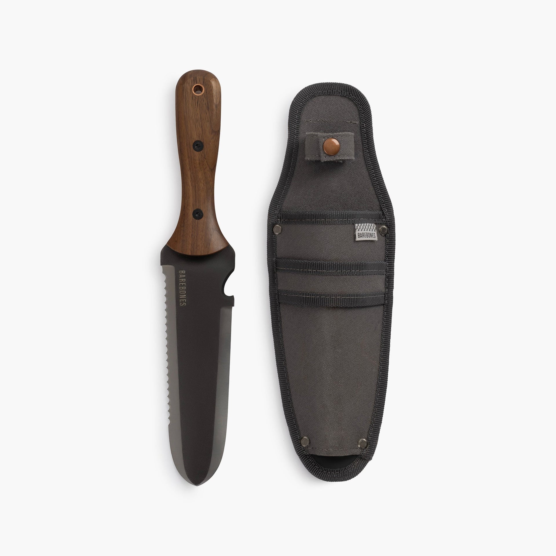

They might have. But a shovel won't cut that fabric you see on the mounds of strawberry or Blueberry farms. Different farmers call it different things, but man it's a pain when mowing rows and it gets caught in your blades. If you don't cut it out it melts into something so hard it's literally like derlin and can need an angle grinder just to cut it off to sharpen the mover blades. The crap pictured below lol. Also, a picture of the only non American made knife I own. Made in Taiwan. There is a Benchmade Limited Edition Ares out there somewhere on those 550 acres that I lost when cutting that crap off in the field, then I put the knife on the mower deck and forget about it because someone pulled up and started talking to me. I drove off with it on the deck. It's the only knife I ever lost. It was M390 a $240 mistake.20230220_161836.jpg20230804_100641.jpg
