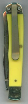

I've got a Case large yellow CV Trapper, and I'm planning to put a pocket clip on it - mainly to make it more accessible with my gloves on. It'll be a nice clip, not some super-modern looking one; I'm shopping this out to find the right style to go with a traditional slipjoint.
Has anyone here done that, and if so, maybe put up some pics? I'm curious to see how a traditional will look with a nice clip.

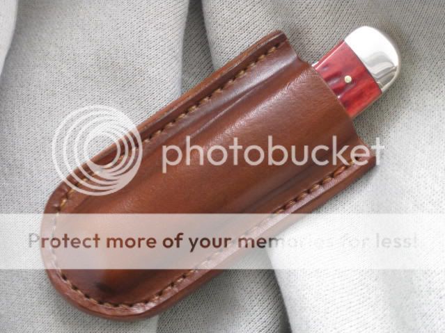

A leather sleeve with a clip on it might do the trick and not alter the knife.
Since I have never held any style of knife with a clip that did not feel better without a clip, I would opt for the pocket pouch with a clip ala William Henry.
While I've done it believe it or not, I have to agree about some of the sentiments shared here. I mean far be it from me to tell someone what their needs are but me personally I wouldn't clip a slippie. There are other traditional knives I feel differently about but most are lockback types and I just feel they do better away from pocket lint and grit rolling around in the lock mechanism but someone mentioned the other alternative and thats a pouch. I carried my Coats Toothpick in a pouch since day one and it still didn't keep it from having problems though. Go figure. Anyway, here is the only Trapper I ever did. The customer seemed to love it. I can't say I'm looking forward to doing another personally though. :eek:
STR

How about --
That is my set-up for when I don't want to carry my trapper in my pocket or need easy, un-hindered, access to it.
I think the clip on the trapper pictured above looks rather odd but Hey!!! To each his own.

Thanks for all the responses, guys. I may put this on hold for a little while and look into the leather sleeve idea - but that clip STR did sure is purty.

I think a leather sheath with clip to house the slipjoint is the answer. I think the clip is too much on it. However, STR did a great job on that yellow handled knife. If not, get yourself a one hander such as a Spydero paramilitary, or BM Griptilian, which is operable even with a glove. I carry daily a slipjoint, a modern folder, and a multi-tool.

Far easier to just anodize the titanium a gold color to look like brass which is not that hard to do really.
