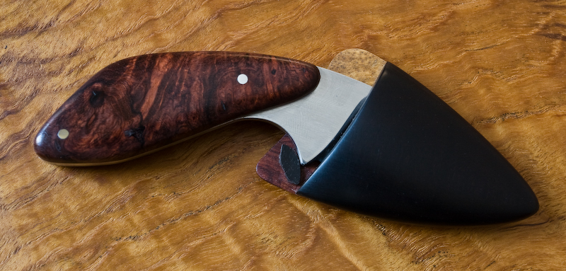

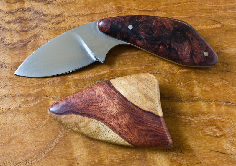

This is a small EDC fixed blade designed to be carried in your pocket. It was made from a small scrap of CPM 154 and some nice amboyna burl.
This knife and sheath was an experiment. I wanted something that I could EDC that was entirely mine. It is small, (blade length is <2"), but fits in hand comfortably and cuts well thanks to the thin edge.
This was my first knife sheath. I didn't want to work with leather or Kydex, so I designed something from wood. The amboyna on the back of the sheath was cut from the same block as the handle slabs. Blade retention is accomplished by a combination of a small magnet and a piece of ebony. The blade clicks into place and won't release until properly rotated.
I plan on carrying this on a regular basis to fully determine what I like/dislike about the design.

the upside of a fixed blade for pocket carry is total one hand access, it looks like your system requires two hands. Looks like it would make for a better neck knife than pocket knife with the current setup.
Nice looking knife and sheath though.
is the wood comfy to carry, it seems kinda heavy and klunky, but I may be wrong.
fantastic knife and sheeth by th way I love the wood on both handle and sheeth
Lorien, you are correct that this one is easiest to use with two hands. It would be very easy to modify this design as a neck knife. I've personally never gotten the hang of neck carry so I left the feature off of this knife. Another option would be some sort of pocket clip on the sheath (that would take some more re-design). The sheath fits snugly in the key pocket of my pants and allows for one-handed operation; unfortunately the pocket is on the right side making it awkward for me.
Nebulae, the knife and sheath together weigh less than my previous edc, the Kershaw RAM. I removed all of the excess material from the sheath and rounded all surfaces. The wood sheath is not soft like leather, but it is smooth and lightweight.
