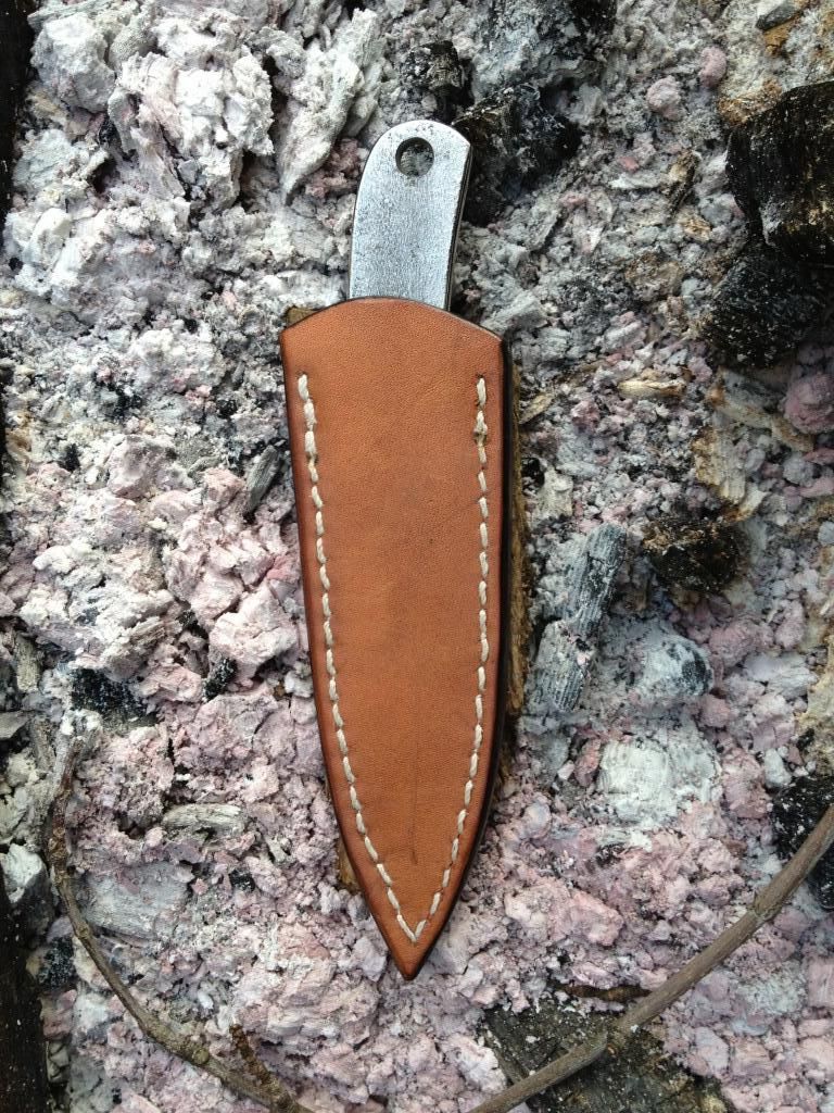

And for the record, I have tried to get Isaac to send me his sheath so I can fix that stitch^^^! :) That was an early effort with my stitcher which makes a lock stitch. Part of that was probably operator error. The hand saddle stitch won't do that since it's a double needle stitch.
...so I can fix that stitch^^^! :) That was an early effort with my stitcher which makes a lock stitch. Part of that was probably operator error. The hand saddle stitch won't do that since it's a double needle stitch.
I just carry the knife a lot.. On the front side of the sheath there is a groove for the stitching to become flush with the surface to avoid friction.. How come there isn't one on the backside? I like the aesthetics of it, but could there not be just a groove for the stichting? (Non groove side below) Btw. the stitching hasn't moved in over year..
Oops, I missed this... No groove on the back because it was machine stitched. I don't know of anyone that uses any kind of mechanical stitcher that puts a groove on the backside, mostly because you run a strong risk of missing the groove on the backside with the needle.
All
of my sheaths that are hand stitched have a shallow stitching groove put in on both sides of the sheath. :)
