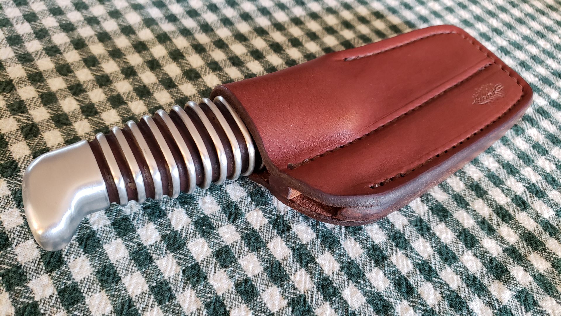

Ive done a couple. the fixed blades I filled the pocket so the knife wouldnt turn. I wouldnt blindly insert the knife though while in your back pocket. lol

I made my own since they are really easy to do, you make them as you need them, you can customize them as needed and I'm really cheap. I read somewhere (can't remember off hand) to make the slip rough side out to keep the darn thing from slipping out of your pocket.
