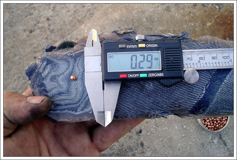

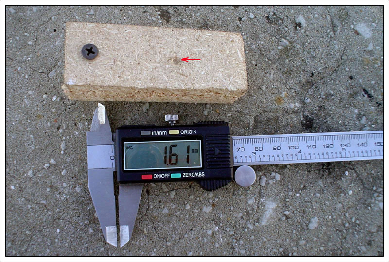

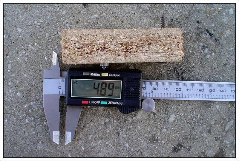

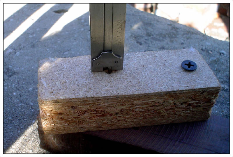

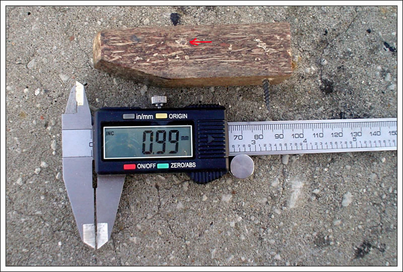

Today I was fooling around in the shop after finishing some knives (pics next week) and decided to show the hardness of the impregnated wood in a non conventional way :D
So I've picked a Gamo CO2 V3 (425fps) pistol and shot round .177" copper pellets to several woods at 3 meters (10 ft)

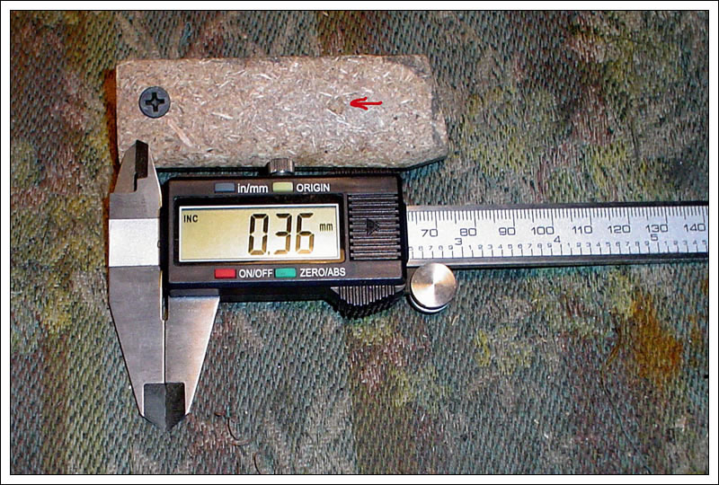

Depth of the mark made in the impregnated particle board: 0.0141"
Depth of the mark made in a regular particle board: 0.0633"
Depth of the mark made in the impregnated particle board (on a lateral): 0.0389"
Depth of the hole made in a regular particle board (on a lateral): 0.1925"

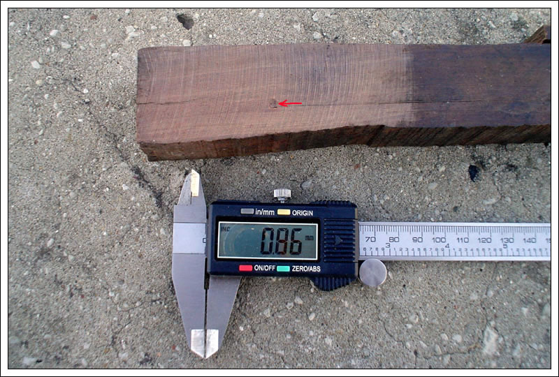

Depth of the mark made in a regular piece of Guayacan (a hard wood): 0.0338"

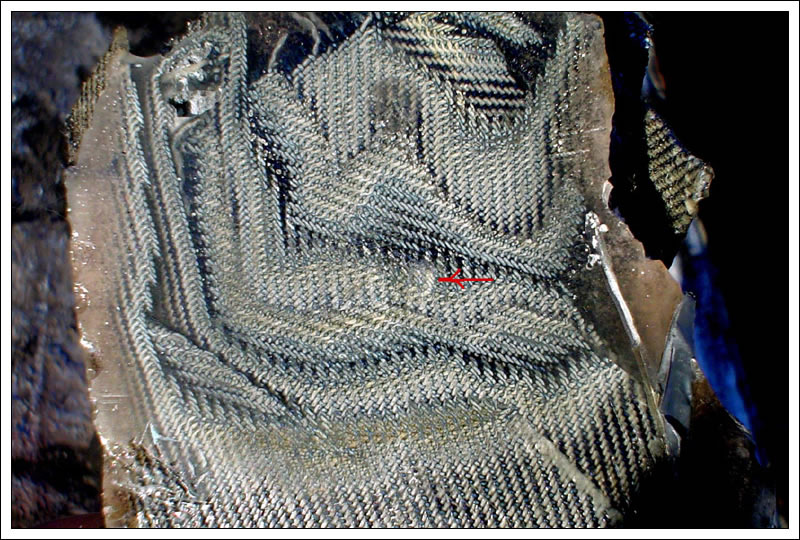

Depth of the hole made in my own made micarta: 0.0114"
Close up of the mark in the micarta.

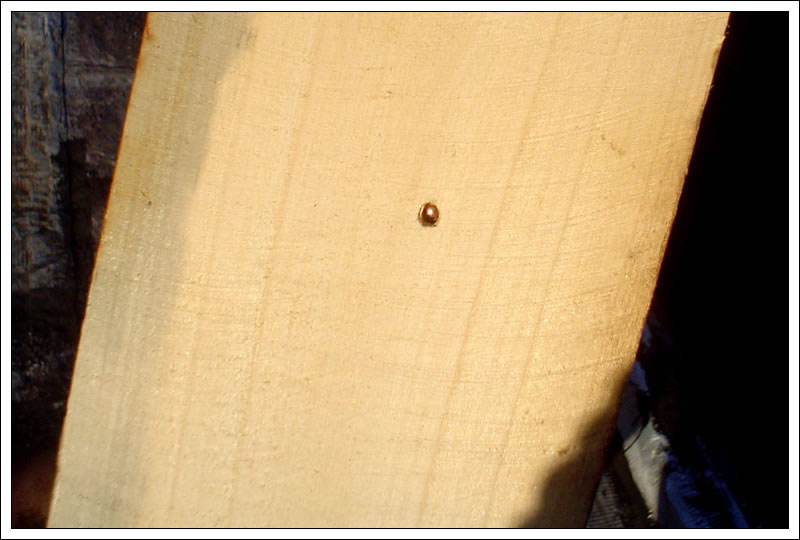

Pellet incrustated on white spruce wood, a soft wood (shot also at 3 meters - 10 ft)
How all the marks/holes were measured.
