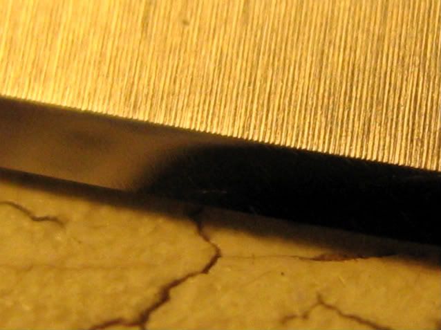

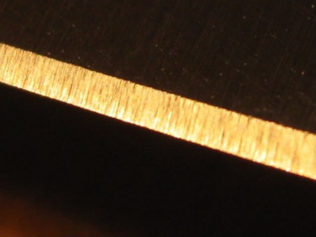

I prepared two knives with rough and polished edges and found in a month of use that I prefer polished edge - it just cuts better, but I did not limit myself to slicing but just regular EDC things.

unpolished sharpness
polished sharpness
Polished to me is a edge sharpened to 30,000 grit or more, I use DMTand spyderco ceramics then finishing with diamond strop paste, all free hand. I will not disagree that a polished edge does not always work best but for most things it seems to be better.
