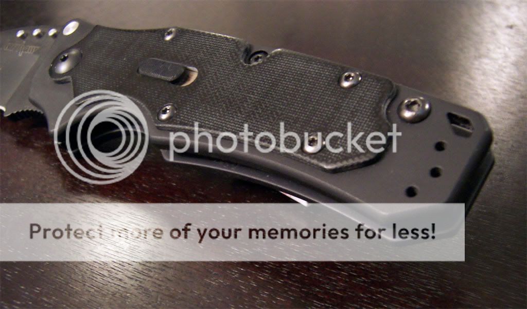

Well after seeing some pictures of the job svrider3 did on his, I couldn't resist and had to try polishing the G10 on my RAM.
Mine:
svrider3's much better pictures:
As he said when he posted his, it looks WAY better in person than it does in the photos. I'm REALLY happy with how it turned out.

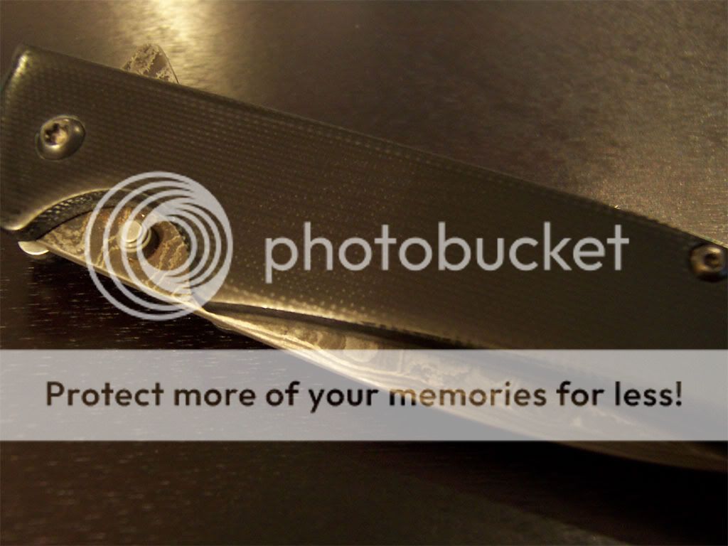

Alright, off to the sink I go, expect an update in ~30 minutes.

GREAT SUCCESS!! (imho)
Just tweaking/resizing/uploading pics, update inc...

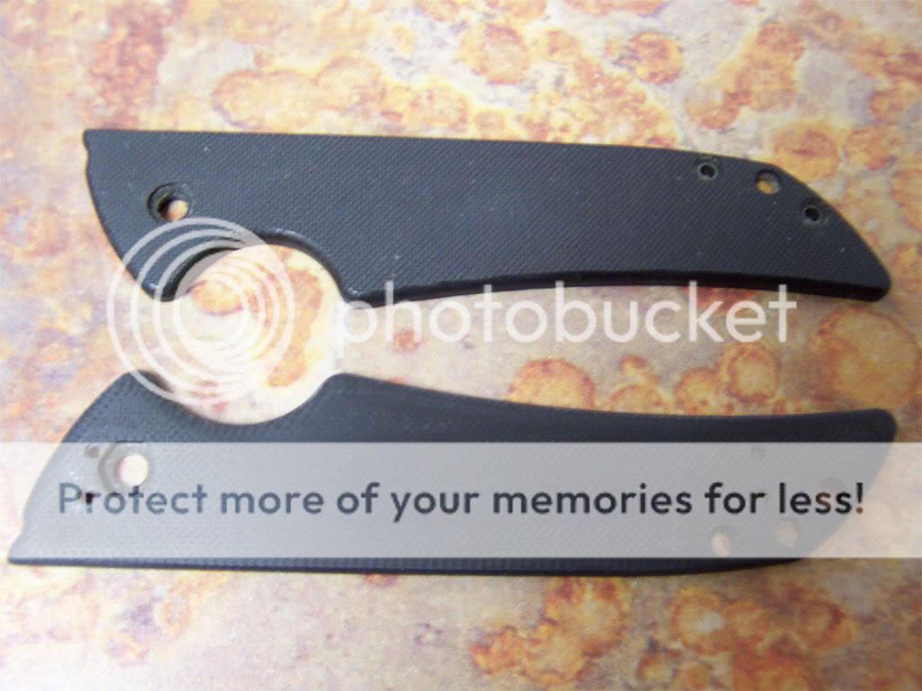

Wow, I can't believe that actually took 90 minutes, it flew by while I was doing it.

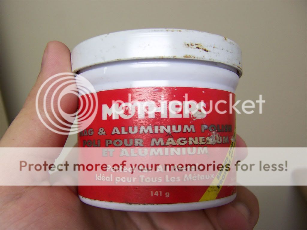

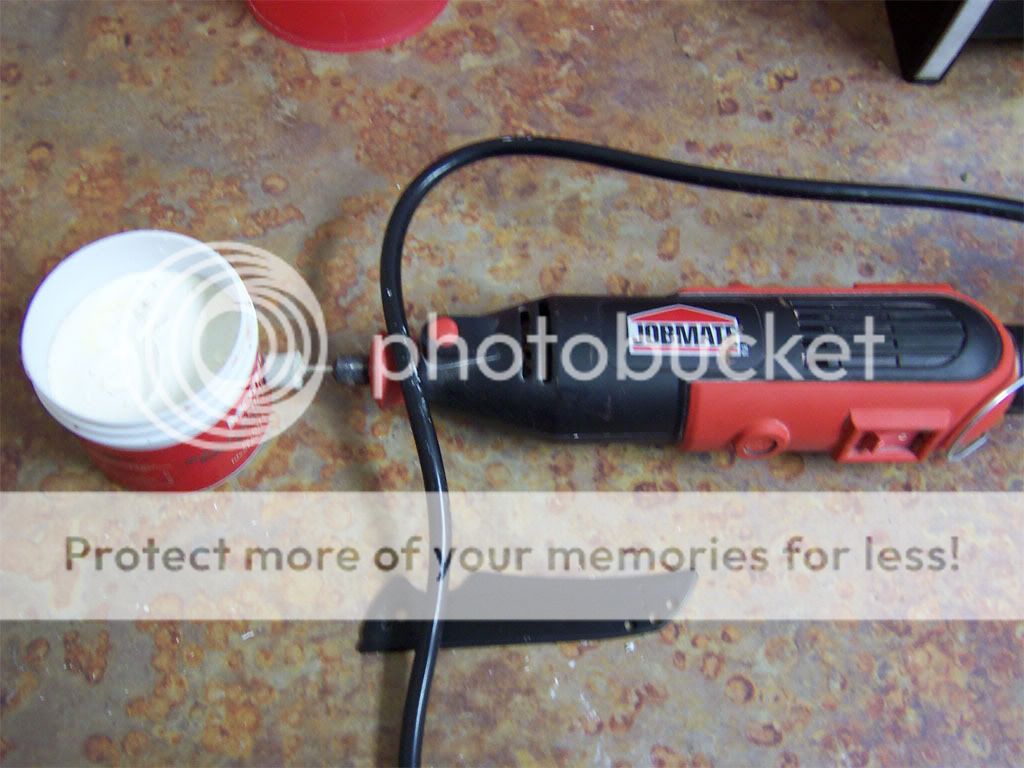

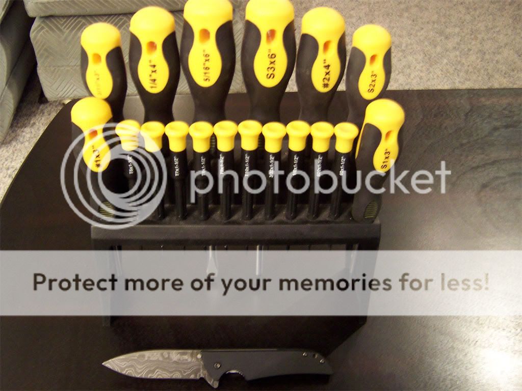

I decided to take a whole bunch of pics and almost make this a bit of a how-to.

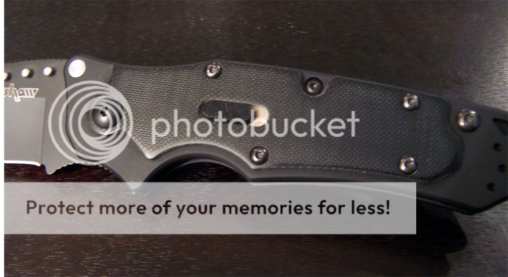

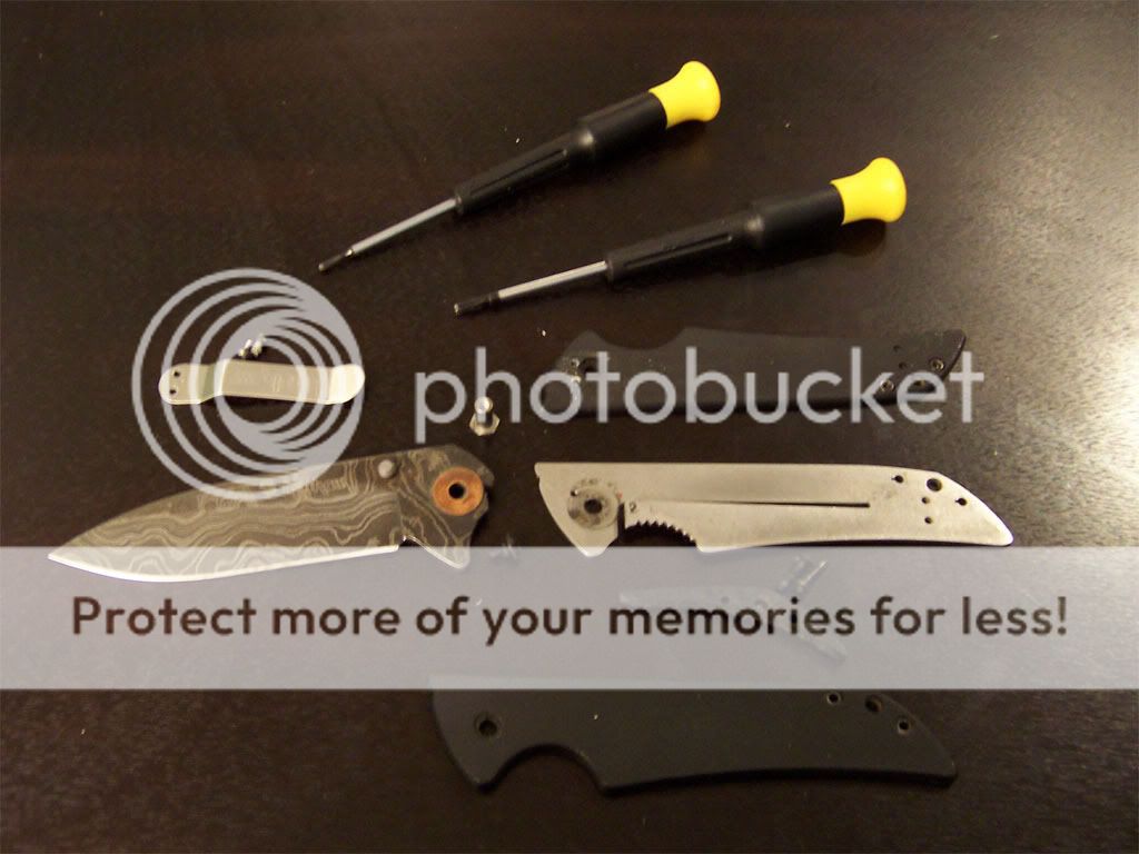

Got the tools ready for dissasembly. Damn Kershaws have worn the writing off of my T6 :D
Here it is all taken apart. I forgot to remove the 2 "nuts" in the back scale before I took this picture, but I did remove them before polishing the scales.

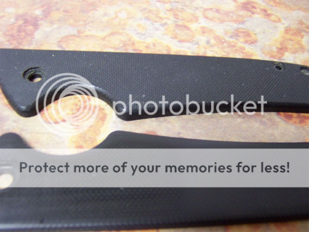

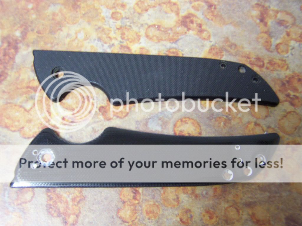

Scales and 400, 600, 1000, 2000 grit sandpaper.

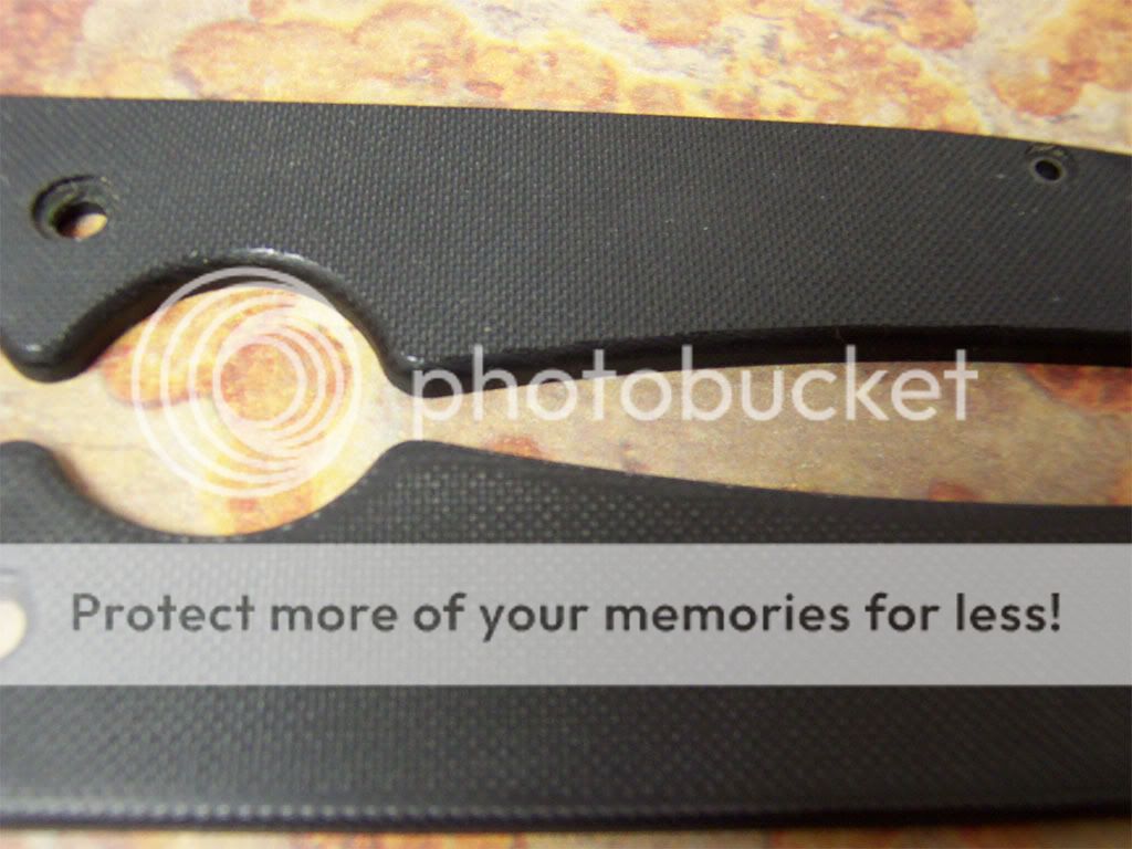

Doesn't show up to well in pictures but, difference between stock and after 400 grit:
Then 600:
Then 1000:
And after 2000:
When all else fails, IMPROVISE!

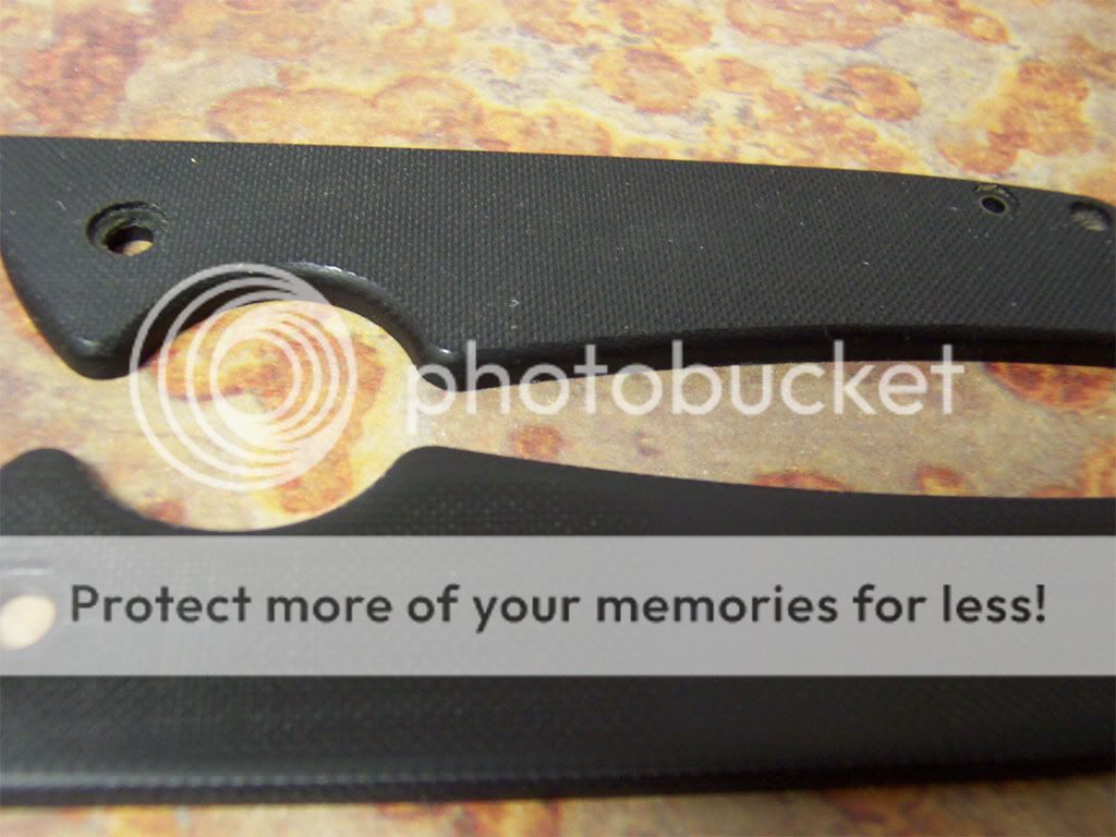

In this pic you can see the white polish stick in the pores near the ends. This tells me that I need to sand those areas down more.
So I went back over the ends with 600, 1000, 2000, and then polished again. That looks better :thumbup::

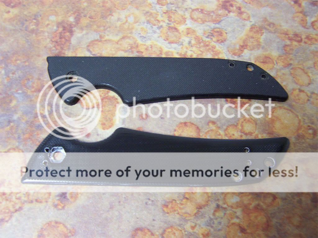

Then I cleaned out all the gunk from the holes and repeated everything on the other side. I was doing the final polish on the 2nd scale when I nicked the scale with the base of the dremel :( So I had to get the scratch out with 600, then 1000, 2000, polish again.
Done deal:

Thanks. Again I have to say it looks way better than the pictures show.
