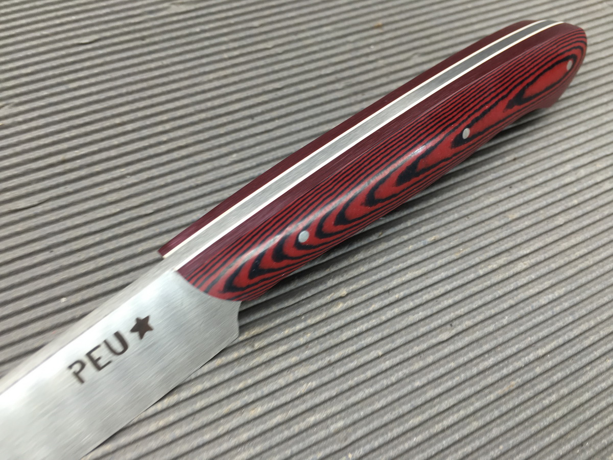

For paper micarta (phenolic) I go to 240, then bosch abrasive sponges then buffing with white compound, nice shine! If you like it even more shinny, go farther with the grits and then directly to the buffer
Pablo
i go up to 600 grit then white, followed by pink compound buffing wheels. it looks shiny and wet. its important when you get done with the 600 that the surface is consistent in color. any areas that look lighter or chalky will not buff to the same shine because they did not reach the 600 grit surface finish.
