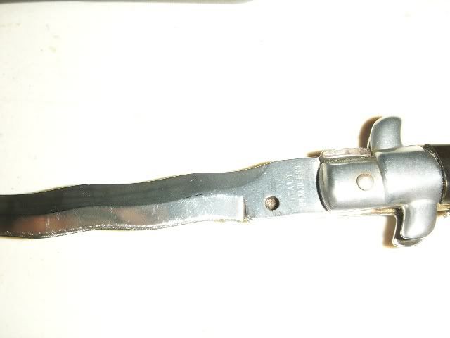

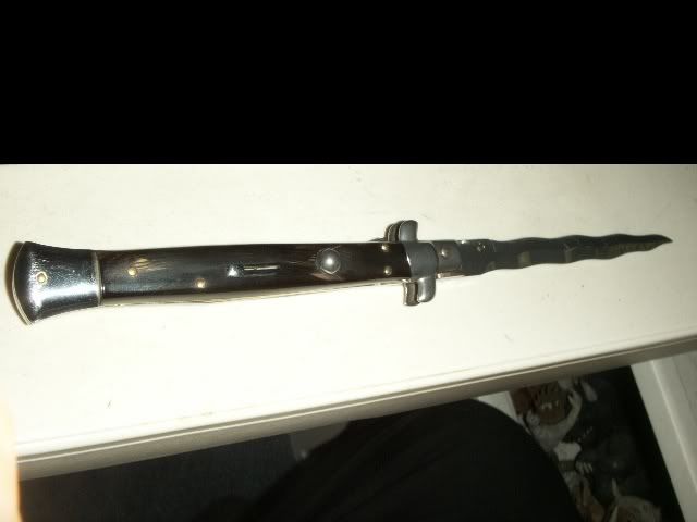

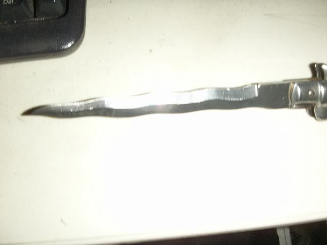

I have this 11'' Italian Stiletto with a Kris blade that is about 15 years old. There are lots of scratches on the blade... some are fairly deep. What would be the best method for "restoring" and/or removing the scratches? I've never tried to polish stainless steel before and I don't want to mess up the geo of the blade. Also the knife is very dull and needs the edge put back on. (I'd rather send it in somewhere if the costs are reasonable) Thanks in advance.

You can sand it lengthwise with wet/dry paper wrapped around a broomstick or similar round object. Start with 600 grit, and see if it removes the scratches. If not go to 400, then 600, then 1000, then 1500, then 2000 grit. You can then wrap a heavy cloth around the stick, and polish with Simichrome.

Judging from the pictures it looks like it's in good condition. I wouldn't even worry about trying to fix it up, especially if it's sentimental. May I ask how you got it?
A friend of mine that passed away a few years back got for me from Italy... might be a Frank Beltrame. The scratches are alot worse than the photos show, you can feel them.
