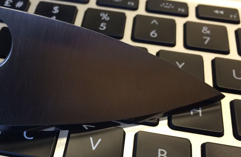

I actually use 2 different 600 grit moldmasters to mirror. The first one I use after the 400 grit is kept flat and clean. A caveat though, never wet the 600 grit moldmasters because if you do, they'll turn to mush. My second mounted 600 grit mm is loaded and glazed. It's the final stone that I use. I can get quite satisfactory polish from the glazed 600 mm. After that, I go to the polish tapes but I old polish tapes with diamond paste. I just clean them and load with the paste.
Here's my S110V native with my treatment.
Wow. singularity35, the knife looks great. I can get a shiny edge (not that shiny though) on M390 but have never seen it on my Manix 2 S110V. I will definitely get and try diamond paste. Do you use the same paste to load #600 stone and tape? What is the particle size? Thanks for the info!

I don't load the 600 grit stone. I just use 2 600 grit stones, one kept clean by lapping when it loads, and the other I just let it get loaded. I use DMT pastes from 3 and 1 microns. I use the 3u on the yellow tape and the 1u on the blue. My tapes are really old too and I think it's just the paste that polishes. I just clean with metal polish when they get dirty and let them dry. The metal polish seems to turn to powder when it dries, I just blow it off before applying paste.

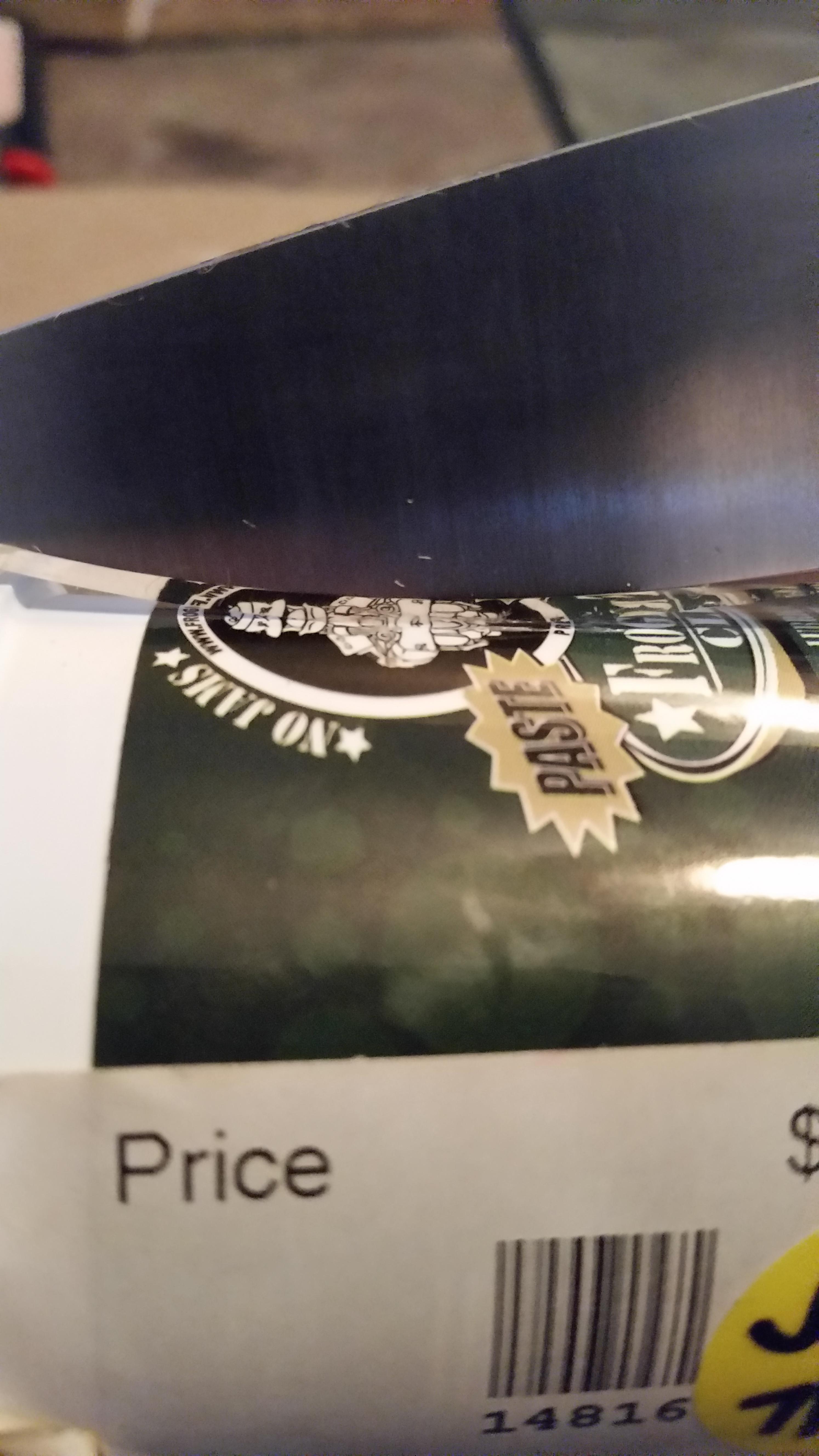

Update. Since I cannot find a vendor which supplies DMT pastes, I tried to polish S110V edge with Edge Pro polishing tapes (#2,000 and #3,000) as much as possible in the mean time. I had to use them much longer on S110V and with more pressure than when using them on other steels like M390 and ZDP-189 to get a satisfiable result. But at least the edge is shiny and pretty sharp.

I added a picture of the edge after using the polishing tapes in my previous post. But the one Bodog showed looks much better......
