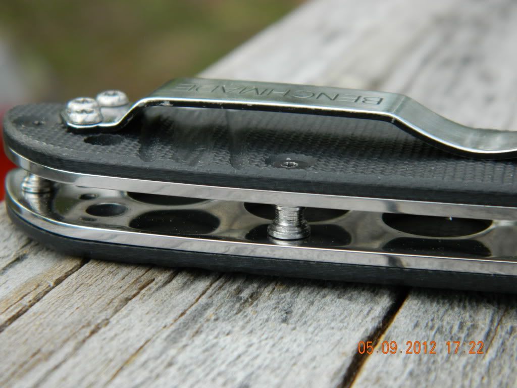

I recently got a high end Benchmade knife with visible stainless liners. Overall the fit and finish is great except for the liners. They have machine marks across the liners which look rather uneven and kind of bad.

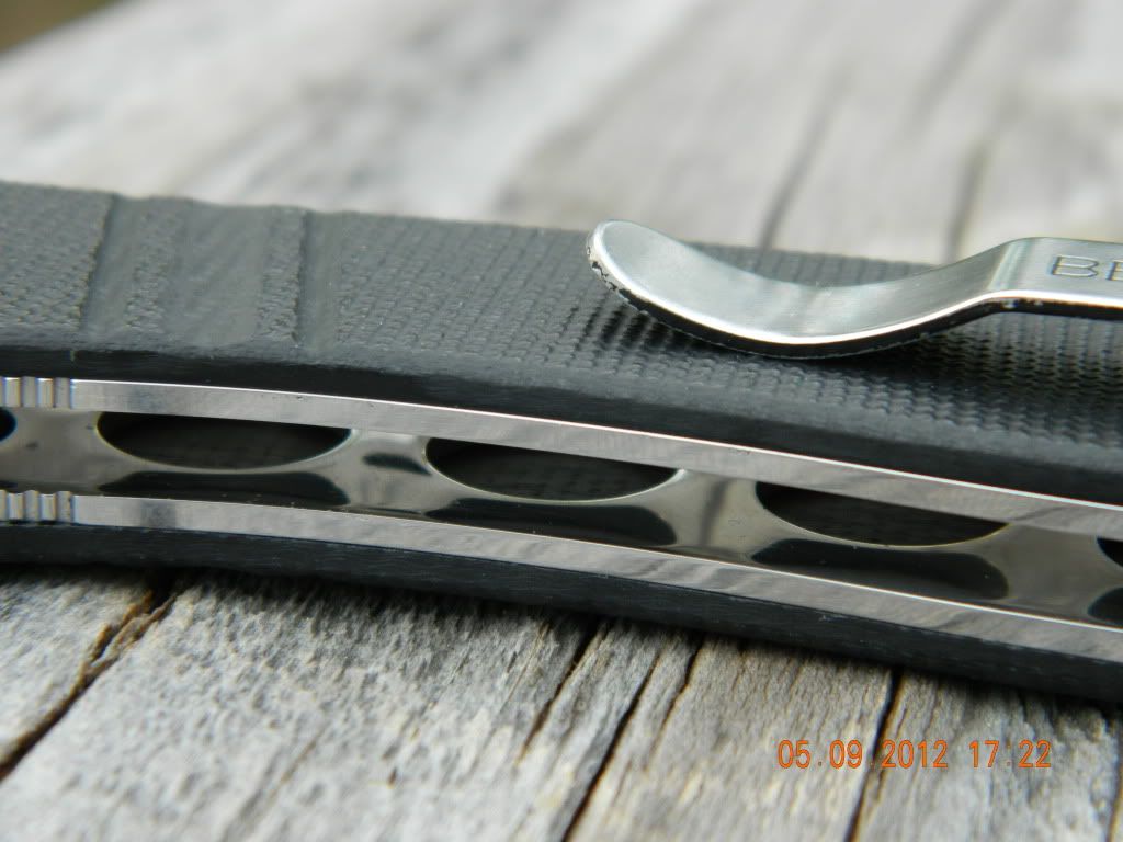

Here's a 710 I did.
I used 600, 800, 1000 & 2000 grit sand paper and then buffed.

Here's a 710 I did.
Those pics look good. Did you have the same machine marks on that 710 that I described? I don't even know that I want them to be super glossy but to just get rid of the cutting marks and make it resemble the blade which is kind of stonewashed looking.
oh, around the sides, I'd shoot for 400 or 600 grit, maybe 1,000.

If you are talking about the machine marks from the laser/ water jet/ etc to cut out the liners, then I think you will be disappointed with Flitz or Mothers or any type of polish. You aren't going to remove any metal with those types of compounds really. They are basically to take out super fine scratches that make the metal look dull. You will need sandpaper to take out scratches you can see and fairly coarse sandpaper if you can actually feel them with your fingernail. The Flitz will be the last step to make them look shiny like Keyman's 710.
I use both Mother's Mag polish and then follow with Flitz but it is the final step only.
