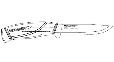

So I have noticed some machetes have large handles,not overly large, but I would like them to be a little less in circumference to make the grip perfect.
Is it possible to change the size of the polypropylene handle with a file and sandpaper . Has anybody done this with good looking effect.
Sure, depending on how thick the material is, extensive modifications are possible.
Start with 100 grit, maybe 80 if a lot of shaping is required. Progress up to 400 depending on how smooth you want the finish.

BTW, I did a similar mod to my Mora Companion HD, using 120 grit on a spindle sander to reduce the handle belly. Made it more comfortable with gloves.

Or the standard Mora Companion..
The Mora Companion HD..
That was exactly the reason I sold them(had a few), and I have only the Mora Companion 2mm thickness now.
The belly was too far protruding on the HD.
Making it suited for only one grip.And even then it was too much.
So you can sand the rubber of that knife too.

Mora Companions have 3/4 stick tangs. You could grind off the entire 'belly' (palm swell) and not hit the tang. I didn't go that far, just about half. I also drilled a .25" lanyard hole in the pommel.

But sanding the belly off makes it that you go through the rubber into the polypropylene part?
