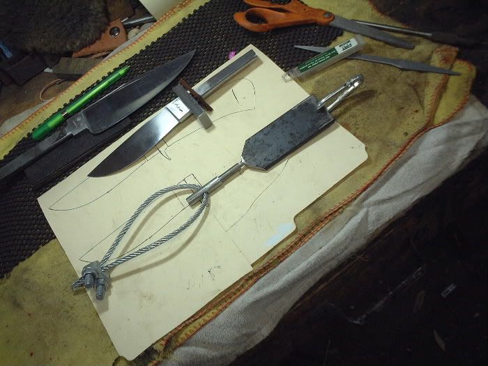

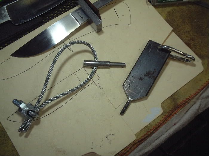

i bought a tap & die set. i am hoping to thin the tang toward the end and make it round and use the die to cut threads in it to make a removable butt cap with a threaded on finial. will the 1084 be strong enough ? should the 1084 be hardened or annealed when cutting the threads ? if it has to be annealed to cut the threads, should i harden it afterwards ? thanks for any tips.
