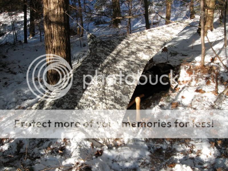

Old pic, but it shows one of my favorite setups with a smaller tarp:
Tie one corner at desired height, stake out other three corners, suspend hood to raise the roof. If there are no directly overhead branches, you can do like I did with my larger tarp here:
Tie a cord higher up on the same tree as the raised portion of the tarp, and stake out the other end so the cord runs directly over the center suspension point. Use a taut-line hitch at one end, and leave the cord slack. Attach the center of the poncho or tarp, and then tighten the line. It will pull up, raising the center of the tarp.

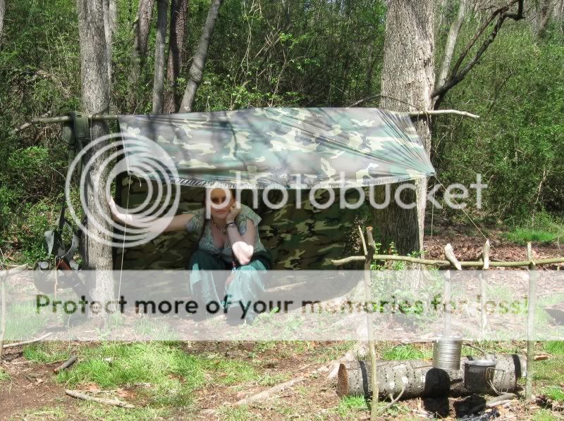

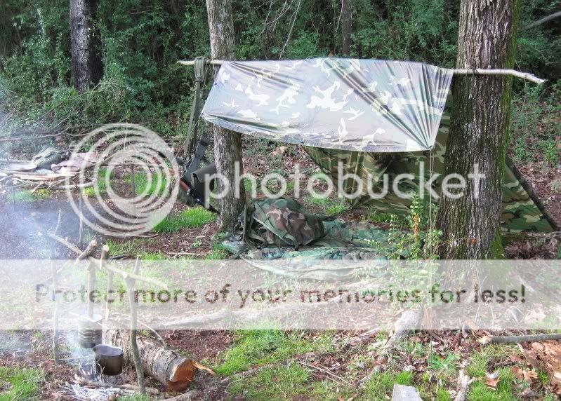

Quick poncho shelter.....
more pics, and links to, of other people's set ups and a discussion on it here...
http://www.bladeforums.com/forums/showthread.php?t=629347
Poncho shelters:

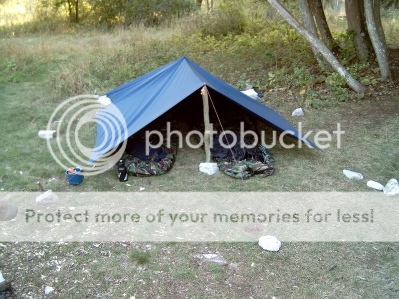

As for 'similar items,' here's a shelter made from a coated nylon tarp. We did a little Origami on this one, and folded one end so it made a vertical wall, thus completely enclosing the end. Rain was in the forecast, so we dscided to batten things down. It did rain, but it wasn't as heavy as predicted:
The rear peak was tied to a solid branch using the rock/monkey fist method stingray posted. I actually use that quite a bit. We secured teh excess material with rocks, so the back flap wouldn't blow open onto us.

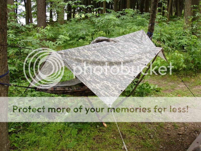

And here is my 'Taj Mahal' hammock setup using an MSR Trekker Tarp overhead:

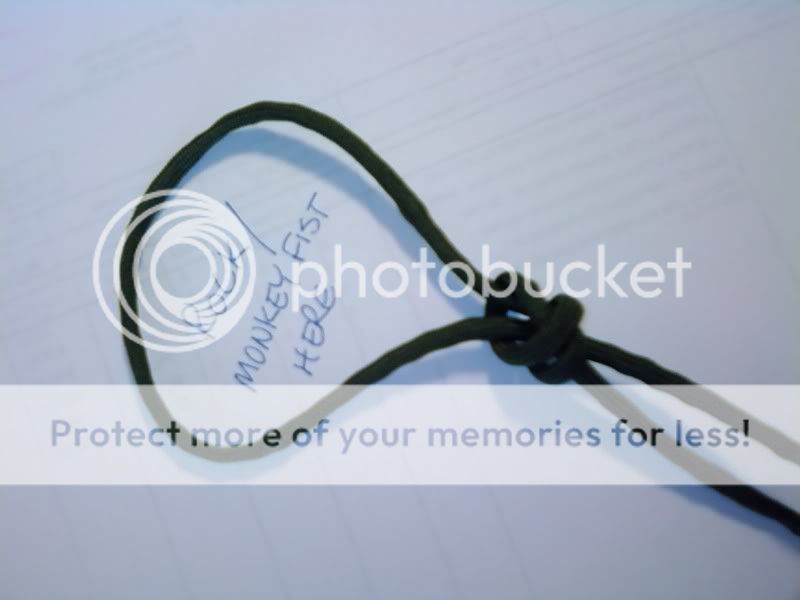

I tend to use a loop made with a simple overhand knot with the rock/monkey fist. It is super-easy and fast to tie and untie, and the loop will tighten itself the more you pull on the main line.

My hammock (in the above pics) is secured to the trees using girth hitches. I just slide them around the trees to adjust the height and tension of the hammock, and they tighten once I get into the hammock. Sometimes they take a little adjusting, especially if one is in and out of the hammock a lot, but they are easiy to loosen and adjust. And once the weight is applied, they stay put.
