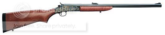

this isn't my gun but mine is a carbon copy
