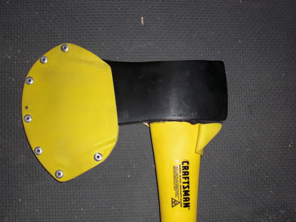

I've always used heavier HDPE - like 5 gallon buckets, kitty litter buckets, etc...Use thin milk jugs or heavier HDPE like detergent or coffee containers? How did you heat it? Oven?
milk jug is a bit thin IMHO.
the thinner, softer stuff will shape if you dunk it in almost boiling water - or use a hair dryer on it.
the thicker stuff shapes better if you heat it to about 225.
the other nice thing about this process is it lets you fine tune a design - then use the "free" plastic as your kydex template.
