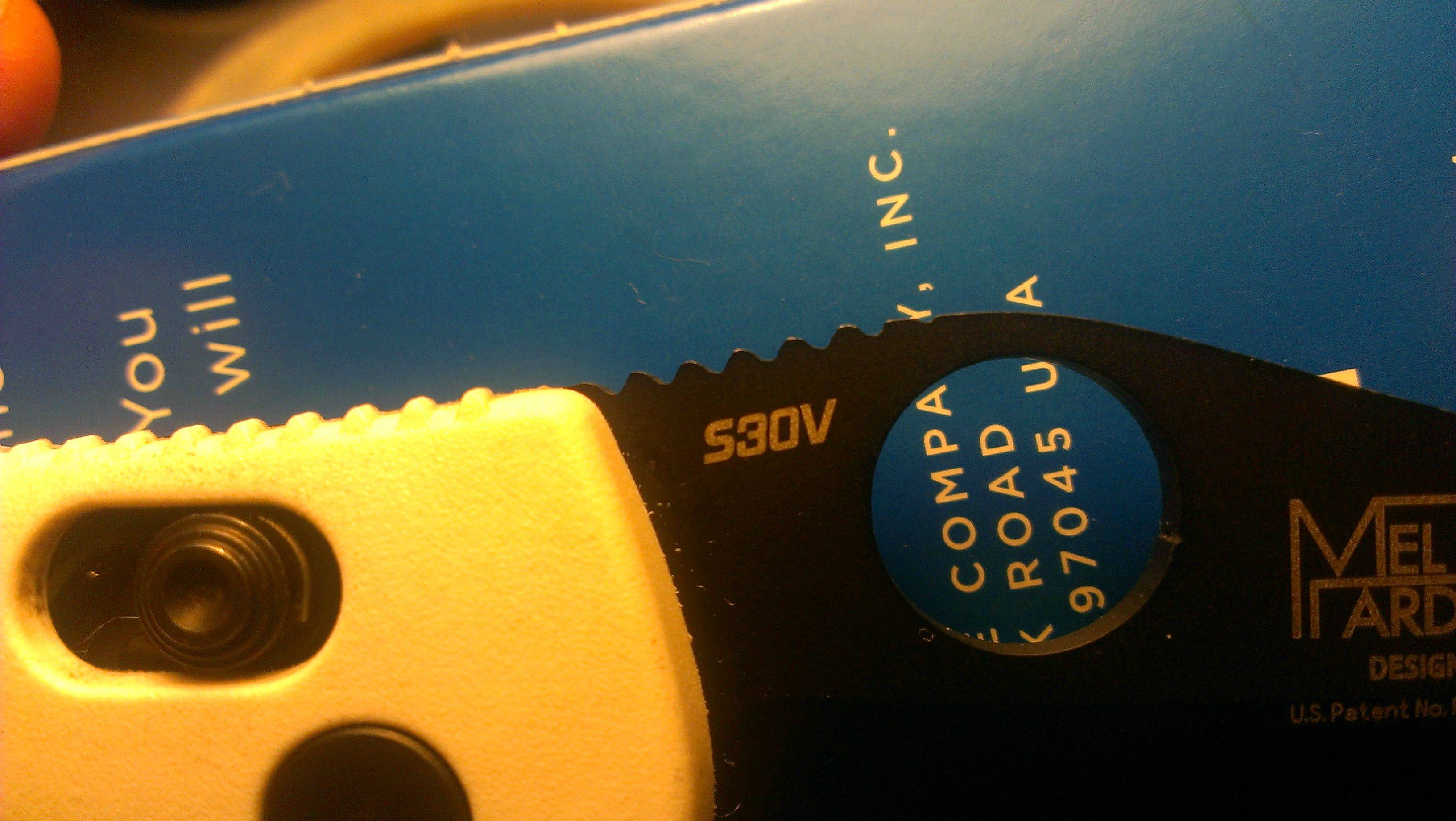

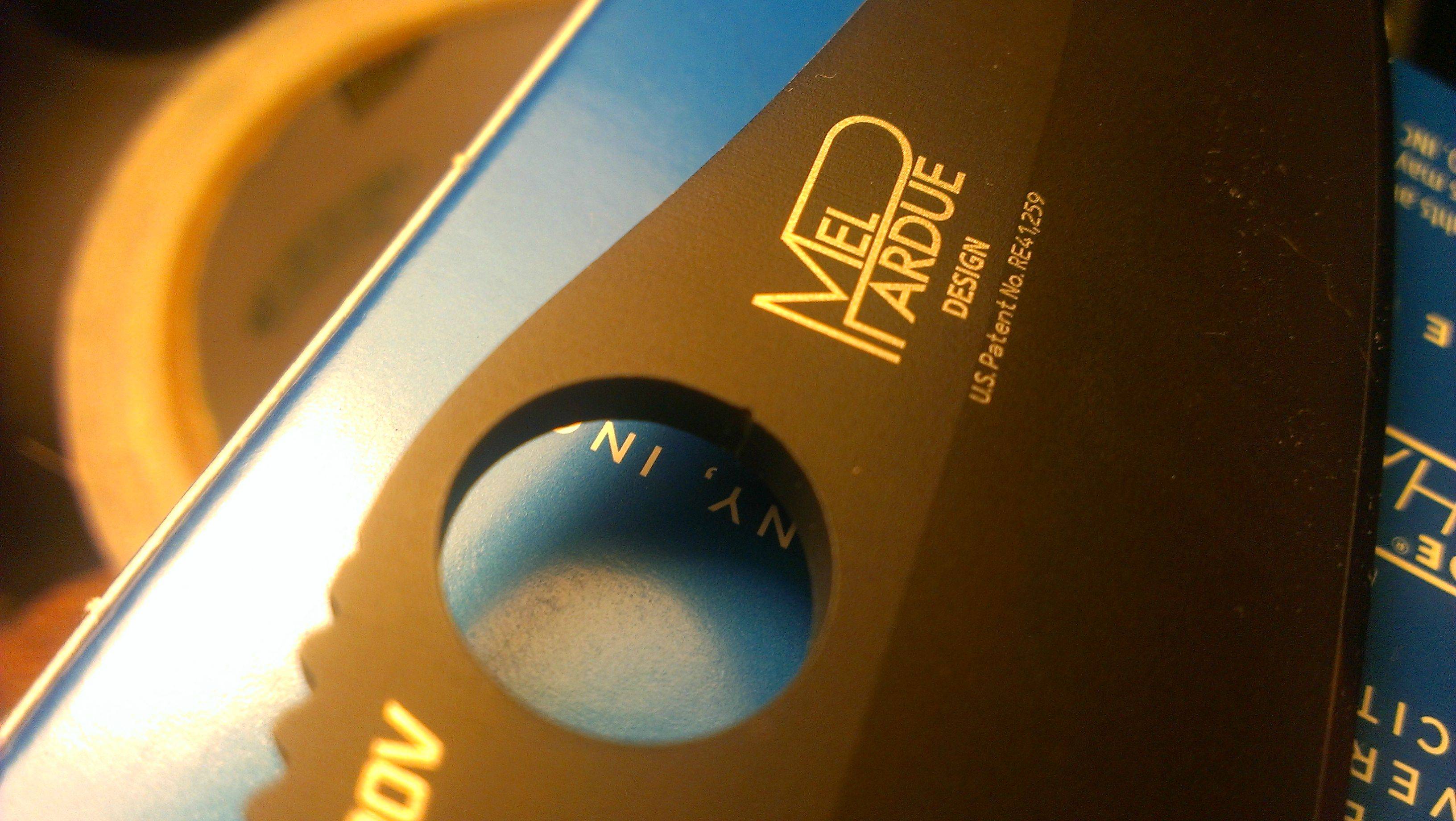

I payed just over 160$ for a custom griptilian with S30V steel and a sheepsfoot blade. The opening hole has a huge notch running from one side to the other facing frontward. there is a random line cut out of the top of the blade almost as if the jimping failed at some point. Also for being S30V it kinda sucks. I put a fresh hair popping edge on it and after just cutting through a balled up paper towel half way its noticeably duller. Im a little ticked off because i waited over a month for this thing to ship to me and payed 160$ for it.

S30v is known to lose it's hair popping edge fairly quickly , put holds a good working edge, I don't see a napkin dulling properly HT s30v , either something is wrong with the heat treat or maybe you had a wire edge? If your not happy call benchmade tell them the knife is Brand new and dulled on you after you cut a napkin, and you believe the heat treat may be off, Their customer service is great and they will fix you up, yea it sucks to send off a brand new knife, buuut, would you rather keep it and sharpen it several times a day or send it in and get it fixed???

the two visual things wouldn't be enough to make me send it in, IMO. Unless that notch in the hole is irritating to open. Unfortunately it's coated, otherwise if that notch was a bother I would smooth it out a bit with an abrasive.
The edge holding... I'd attempt to sharpen it again, check really closely for an existing burr/wire edge when you think you are done, that's the only way I could think of it dulling that quickly unless they just REALLY botched the HT.

There are no perfect knives, even at 5 times the cost, but those flaws are really out of character for Benchmade. I would send it back, and get it fixed.

Production quality control and a faulty heat treat sounds like something they should respond to and fix for you. Between a soft S30V edge and that 'notch' in the thumbhole I'd suggest sending it in under warranty conditions. Call them at 800-800-7427 and ask for Customer Service.
