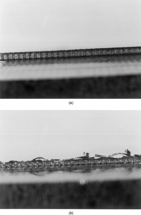

Burr formation can screw up any good steel. Here are some examples.
In the last image you can see that if one has a burr on the edge, the knife will not cut properly and one would get poor results.
