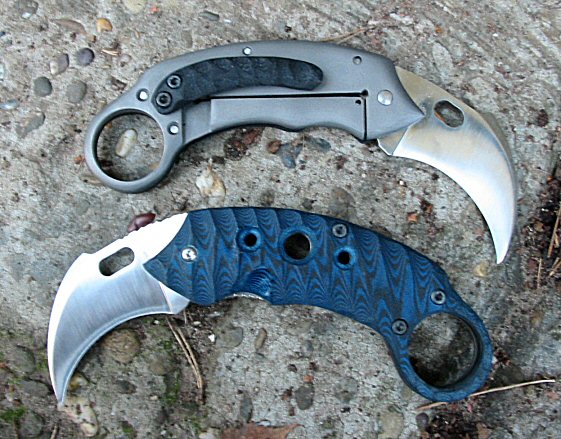

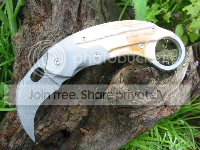

http://forum.weapons.be/showthread.php?t=5295&highlight=karambits
http://forum.weapons.be/showthread.php?t=16425&highlight=karambits
These are by a talented Belgian knifemaker
those are nice... i bet all of those are all around 500 though
I think it might be just because a karambit is such a specialized knife. With a more general bladeshape, you can use it for a lot more, while karambit, and hawkbills, are specialized for slashing.
Where would i be able to get one of those knives.... just for future reference? Im liking the blue one with what looks to be G-10
I've send a PM to the maker on the forum where he posted those knives.
I've copy/paste-ed the links to the subjects of the forum where he posted those knives under the pictures.
If you like, you can contact him trouh that site. He's a friendly guy.

Hi Guys,
I made the karambits in the pics. the first ones are about 7 years old. And I learned a LOT since then. :)
At the time, I really didn't like making them, because it took a LONG time cutting out the titanium handle. (didn't have a band saw at the time) Making one of the kbits took about as long as making three other folders.
And still now, it's challenging. Because the blade is ground very thin at the edge, it warps in Heat Treatment almost every time. Gives me a headache.
But I have to admit: the damascus/mammoth one with the S-shaped bolster is one of my favorite knives I've ever made.

While I did use a mill to help cut the lock, it could be done with a drill press or dremel. The mill makes it more accurate and faster. THe lock face on the blade can be done on belt grinder. I also carbide plated the lock to prevent sticking/galling between the steel and titanium. Using a band saw and mill, it probably did not take much longer than any other frame or liner lock. Designing the blade/handle to work together took the most time.
