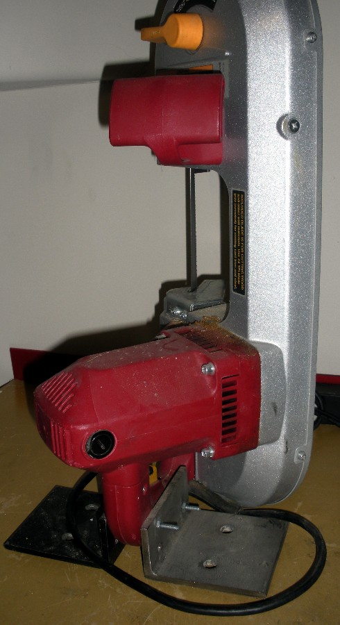

Also, it helps if you put some "feet" on the saw so it will stand up while you use it. I used two L-shaped brackets screwed into the bottom of the handle.

It's what I've used for everything, including 5" wide stock. Definitely +1 on mounting it. With just a little ingenuity, you can mount it on a base and add a small table.

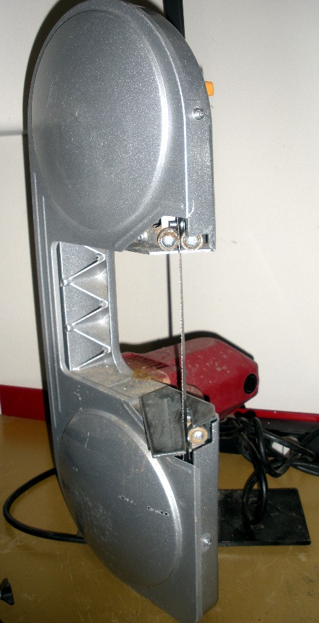

When I mentioned putting feet on the portaband, this is what I was talking about.
Note that you could bolt the feet to the worktable as well, but I never found that necessary.
