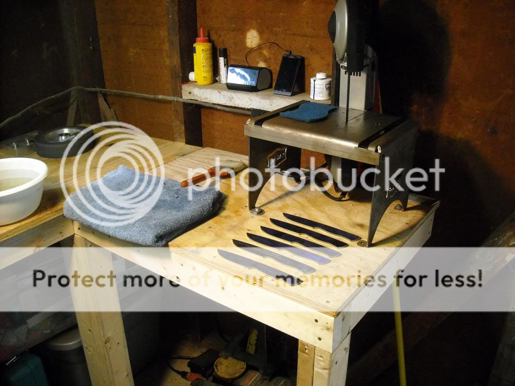

I use a Dewalt 4.5 inch angle grinder with a 1/16 cutoff wheel to whack off pieces around my blade tracing before using a 2x72 belt grinder to finish the profile but I bought a "Swag off road table" for a new Milwaukee deep throat portaband saw and it works really well to cut off bolster pieces and cut pieces of sheet brass and nickel. I still use the angle grinder to save my band saw blades because the portaband is slow and band saw blades are kind of expensive and a minor pain to stop and change them. If you can afford it I would buy the Swag table and a Dewalt or Milwaukee portaband because you will use it frequently. Just my opinion . Larry Lehman

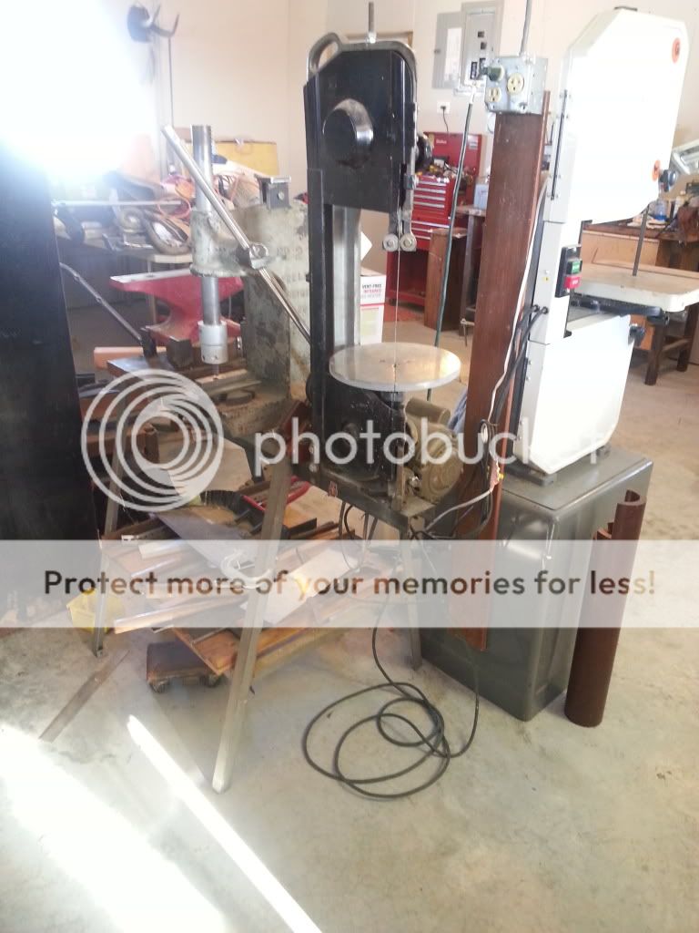

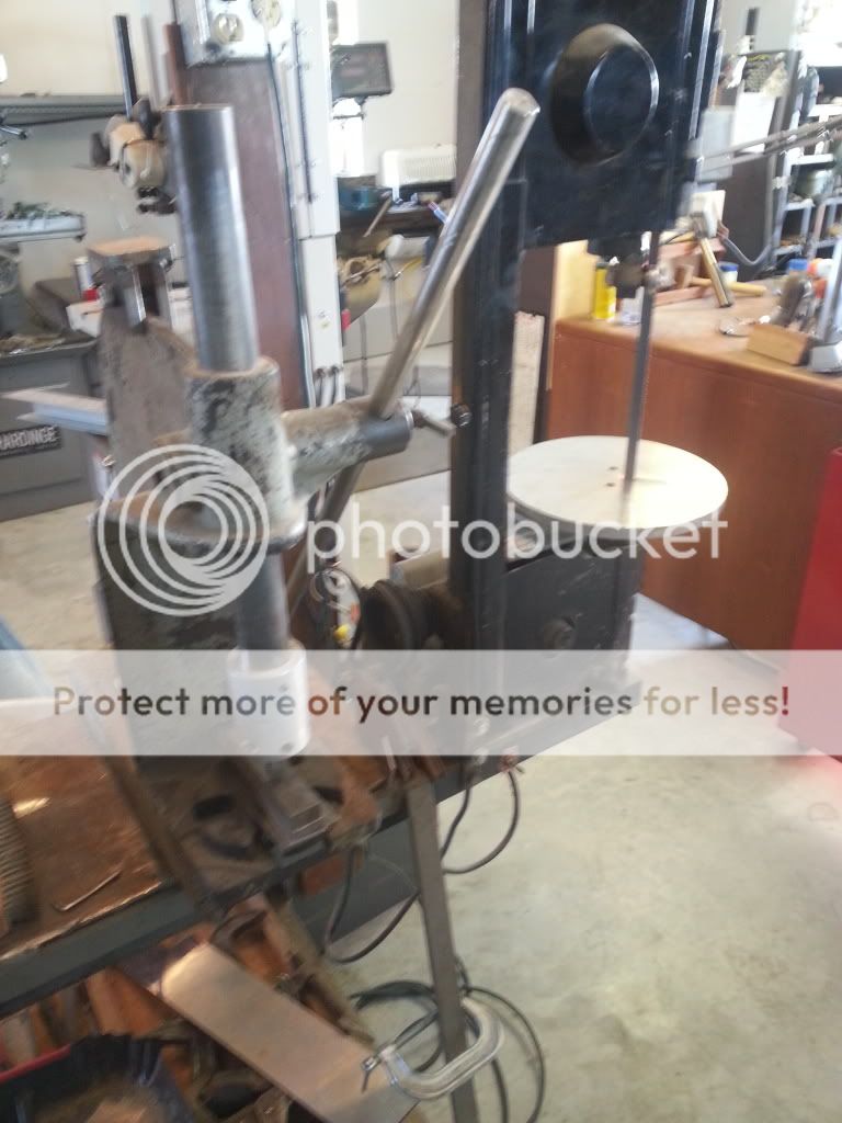

This is an old buffalo I been using for 7-8 years. I made a table and shims for then mounted it to a heavy anvil and press table via a piece of 3" channel. Its not the fastest thing on the planet but its strong and pretty accurate.
