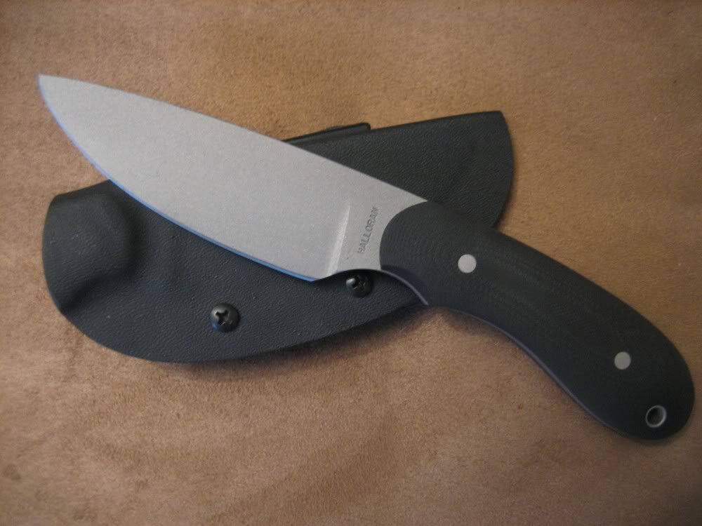

This is one of my D2 small utilities. I had sprayed on some black gun kote, but when it came out of the oven I saw that it had some dust in it. Throughout the rest of the process I tried a lot of ways to get rid of the dust, but there was no way it would look good enough for me to send it to the customer.
So I bit the bullet, threw it in the blaster cabinet, cleaned all the gun kote off, sent a picture to the customer, he liked it a lot and so do I. SO nicew when everyone is happy and a screw up can be resolved so easily.
Bos heat treat 59RC
4" blade
4"handle
Black G10
Stainless screws
.190" thick
