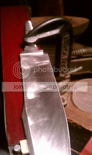

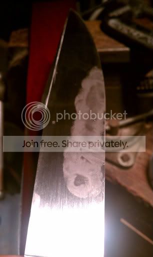

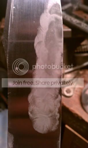

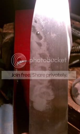

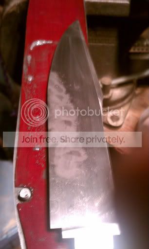

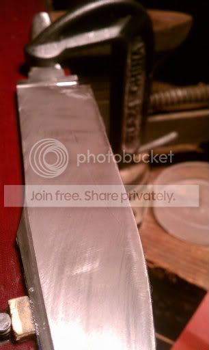

I am hand sanding a blade I have been working on. I already hand sanded one side to a 600 grit finish, after taking it up to a 800 grit dirty finish. Now I turn over the blade and I am working with 280 grit and I notice a line after I apply WD-40 and start sanding. The line looks like a crack, but I do not see it when there is no WD-40 on the blade, and even after applying WD-40 it only shows up after sanding enough to have "dirt" on the blade. I did not see anything at all like this on the other side. It is so long that I would think it would have gone all the way through to the other side.
What do you think, is this a crack?
NO WD-40
After WD-40 and sanding '
It seems hard to imagine a crack not making it to the edge or other the side. I'm going with scratch or flaw in the material.
I decided to finish the side with the anomaly in it. I saved the WD-40 + 600 grit waste to dab on the opposite side and nothing.

Keep on sanding.
Are you saying it will show up? What grit do you think it will show up at? Also is it possible a "crack" that long on one side of the blade, would not go through to the other at .050" thick?
I could hit it with a buffing wheel. would that work (to have the crack show up)?
I'm saying it will either go away or stay there. If it stays the same, it is a crack or slag inclusion. If it gets smaller or disappears, it is a minor flaw or a deep scratch.....sanding the surface down will tell which it is :)
And, yes, cracks can be on one side only.
Sometimes there is a mar or scratch that "burnishes" the steel. It may be caused in grinding, or an impact or hard scrape with a hardened surface. It will disappear when sanded, only to reappear as a bright line when polished. These can require going back and removing a few thousandths of an inch more steel to get past the compacted steel surface.
