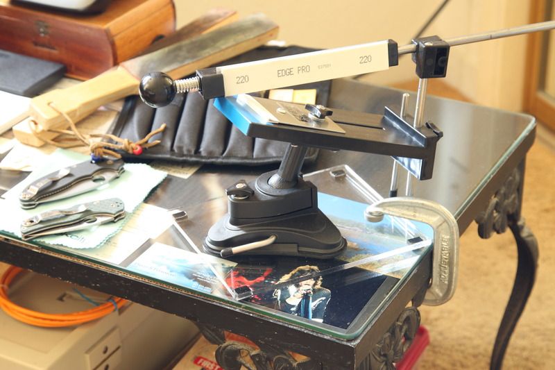

[URL=http://s1157.photobucket.com/user/blanex1/media/BGBB7072.jpg.html][/URL]i started with the sharpmaker,and find that it really handy for tuch-up's with most all my knifes! but found i needed something for changing my or re profiling my edge's a bit faster!and didn't wont to dump 250. so i ended up getting EP/copy with the real EP-stones,this system is working grate for me,its just another way around for you!or you can add other stones to the sharpmaker to make it work better!but going to be slower.
