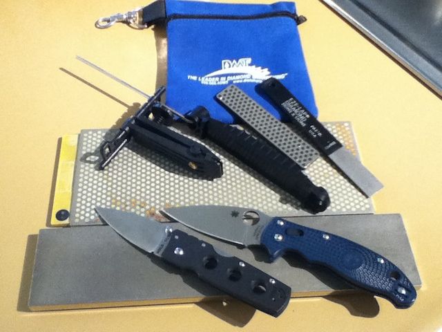

I was enjoying this thread and it reminded me to finally take some coarse diamonds to my pride and joy Manix CPM-S110V.
So while I was between posts here I went and got out the large Coarse DMT plate with continuous diamonds across its surface shown in the first photo bellow. Then I was reading the bit about light pressure. Long time ago out of frustration while attempting to flatten A2 wood working plane blade backs (very large surface like 2-1/2” by 2-1/2”) I applied ALOT of downward force on that stone after using it for days and hours and hours each day ATTEMPTING to flatten a number of A2 blades. First with light pressure as recommended.
It seems to still be quite usable as a sharpening plate though obviously not like it was when new.
Then I recalled I wanted to go more coarse anyway so I thought about the yellow plate with the round holes all over it.
Same exact over pressure on it as well.
Both have been used with and without water. See the rust on the yellow plate.
I pretty much never use the first plate and mostly only use the yellow one for flattening water stones. which it still does VERY aggressively and well. It is very flat checked on my Starrett surface plate with dial indicator . . . point being it makes the water stones very flat.
THEN !
I remembered the brand new little 220 DMT that came with my knife sharpening kit shown. It was never forced at all. I don’t think I have ever used it. Matter of fact I have only used the whole kit a couple of times and found it sorely lacking for little folding knives like a Case Medium Stockman. Just can not go shallow enough and the clamp gets in the way big time. It works for larger folders fine.
I just went back to hand held sharpening using my water stones for the little folders.

To be clear these are what I wasted a fair amount of time with today.
The knife cuts stuff, sort of, but she aint much. Three days a go it was hair whittling. Today before "sharpening" there were NO dings just a little dullness and a bit of slightly rolled edge here and there. If I had had a ding or chipped edge, at light pressure I could have been there all night.
