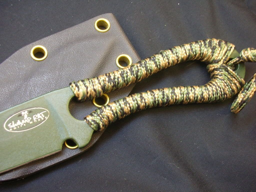

I really like that!
How did you shape the leather to fit in the space before you started drilling?
Anyway, it looks great. I'd be curious to know how it does over the long run...
I just laid the blade on top of a piece of leather and traced the shape, then cut it out with an Olfa cutter, making sure to cut it slightly larger than the trace, I then smoothed the edge to fit using the dremel with the drum sander attachment, I then drilled the holes, wet the leather, then pushed it into place with a bit of force. This deformed the holes slightly so I re-drilled them once the leather dried a bit.
