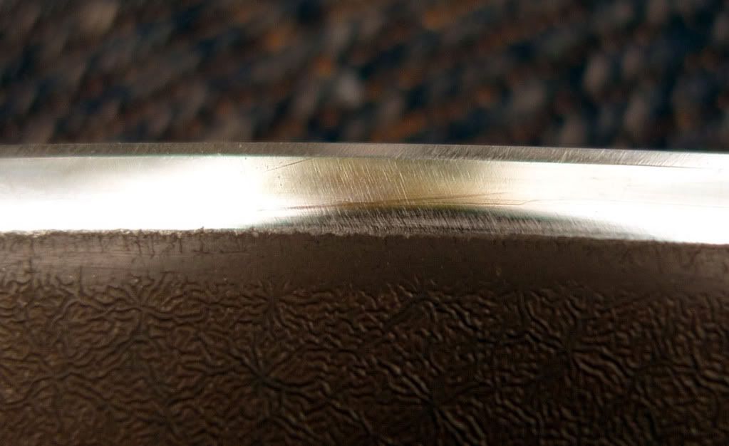

So to measure your edges thickness you'd take something like this (from longislandindicator.com):
and measure at the line between bevels:
Heres an example of an belly/tip that was taken down to relatively thin for it's size (the bottom knife, a KZII) and one that was left relatively thick (the top knife, a B11). The kzii was so thick that I did 5 or 6 bevels to give it a rounder profile, leaving the edge itself to be a thin 24 degree bevel. On the basic 11 I got really tired of sharpening it, and I intended to beat on it pretty good so I just let the 24 degree bevel take over half the edge profile, probably at something like .050" at the tip and belly.
