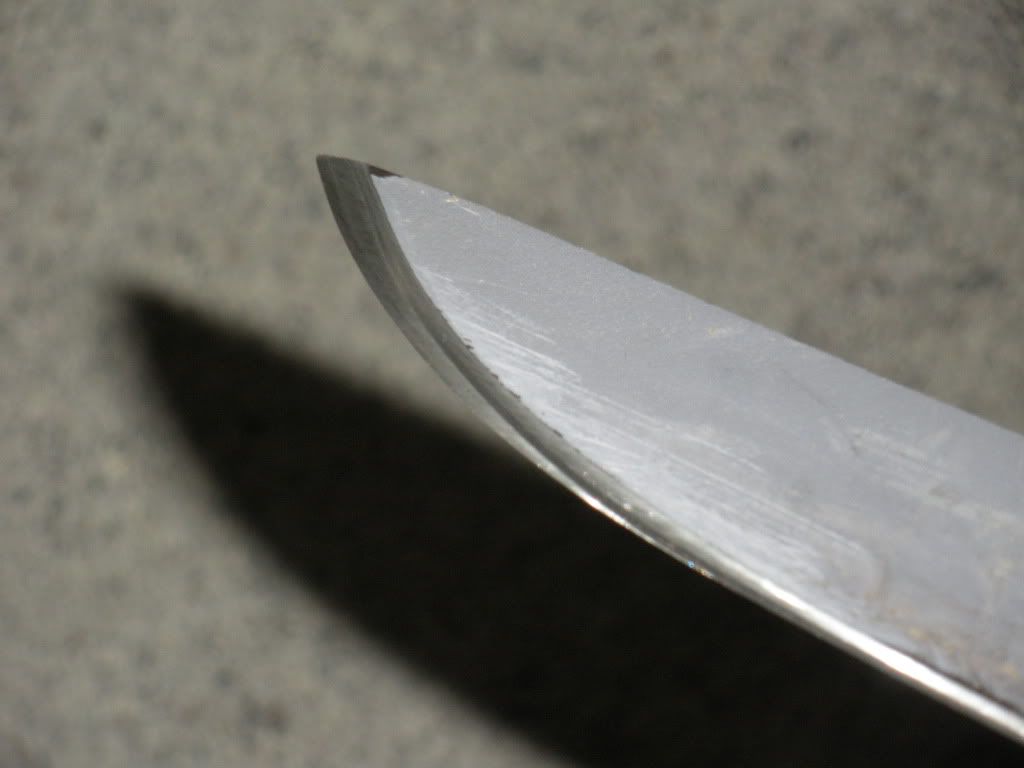

If you want to make sure the angle is where you want it to be at the belly and tip, you could probably reclamp it at a slight angle so the stone is come up to it at an angle closer to perpendicular.
I got half way through yesterday and realised I should probably re-clamp it. I'll stuff about with it this morning and see what I can do. I'll post a pic when I'm done. Hopefully it's a pic of a sharp BWM...
Chris.

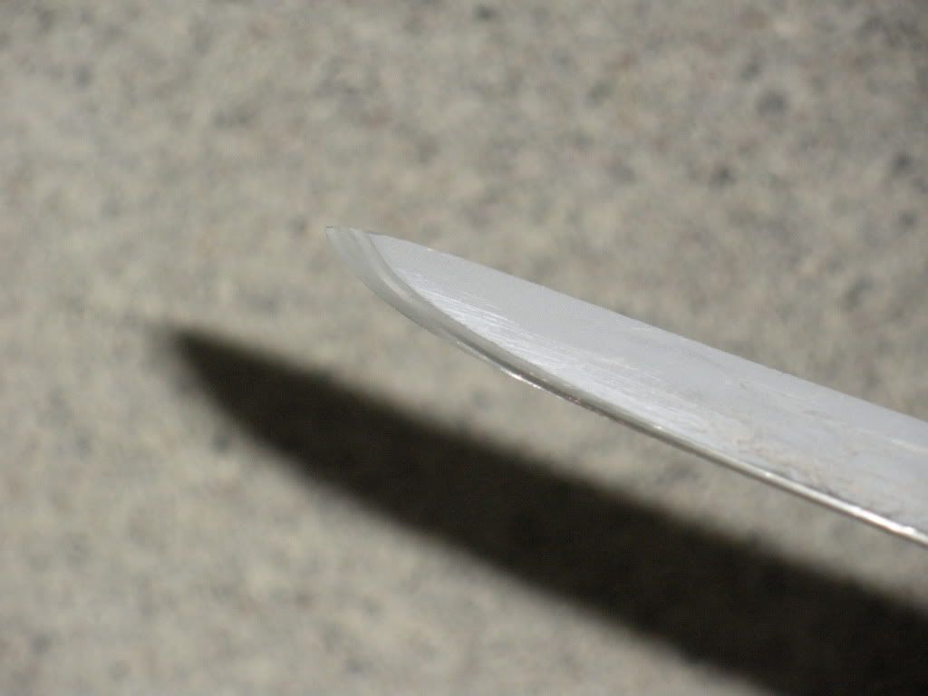

Well, I'm done. I used an 18 degree back bevel like you recommended and a 24 degree edge. Through the belly and to the tip I had to move up through 24 to 27 then put a 30 degree edge on. I only worked it to a 1000 grit stone. It's a user, a chopper that I take camping, so I figured I'd just be wasting my time getting a mirror polish. I tried getting a pic of the edge through the belly but I only have a point and shoot so it was a bit hard to capture it properly. Here's what I got anyway:
You can just make out the 4 angles - 30, lots of 27, 24 and just a bit of the 18 remains at the tip. Thanks for your help with the info.
Chris.
