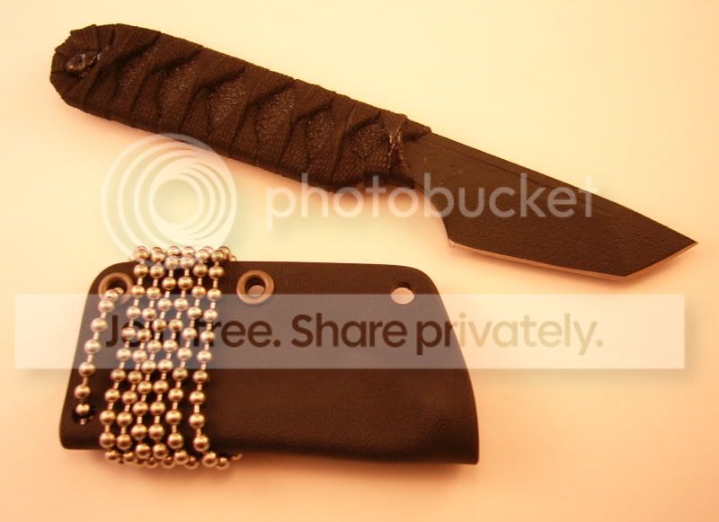

Ceracoat is the toughest ive found. I have used it on guns and knives.
Duracoat and Guncoat are both good products as well, just not quite as tough as ceracoat.
Here is one with graphite black ceracoat. I made this one for me to use and abuse just to see how long the coating will hold up. It is doing well after just 2 weeks of work, although I work in the oil fields so my knives take quite a beating.
In general I agree with Ed, that is any coating will eventually wear.

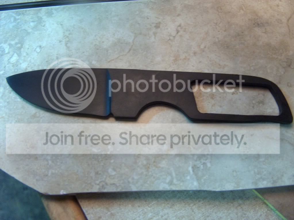

I have had good results with kg gun kote 3400. I have taken brass rod to it and the gunkote filed a good 1/16"+ of the rod before I hit metal. make sure you get the stuff that you have to bake. its really good stuff.
-Josiah
