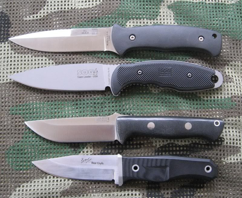

My favorite new knife, the BRKT Bravo-1 SS is in CPM154 steel. Seems to hold an edge well. Lots of makers are using the powdered steels now. Shown below are the Al Mare SERE Operator in S30V, SOG Team Leader in 20 CV, Bark River Bravo-1 SS in CPM154, and the Bayley Bear Grylls in RWL34.
Other than the Bayley, all these knives are readily available.
