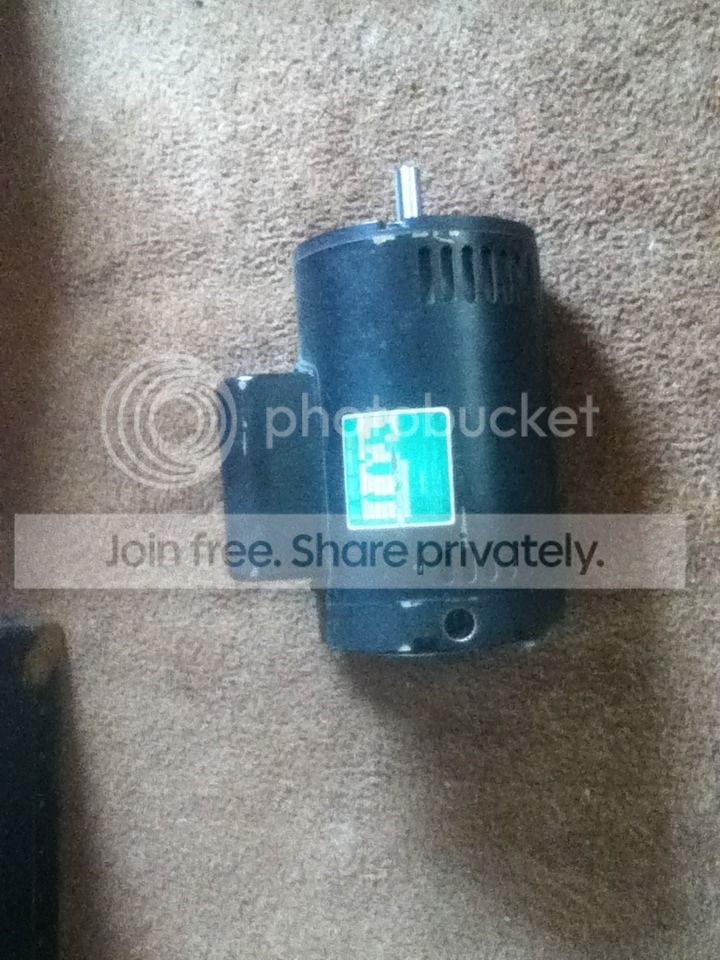

Last week I brought home this used motor to power the beast, 1.5 HP industrial motor, single phase, 220 v.

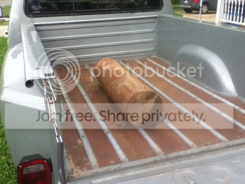

Then today whilst wandering the scrapyard I found the right hunk of steel for the anvil, 9.25" dia steel, 3' long. Weighs in about #700.

Timos, thanks, I do love my truck. Now I just gotta figger out how me and dad are getting this thing out without mangling my bed. ;)

With the preferred 10:1 anvil to ram weight ratio, you can run a 70 lb. ram, a decent-sized power hammer.

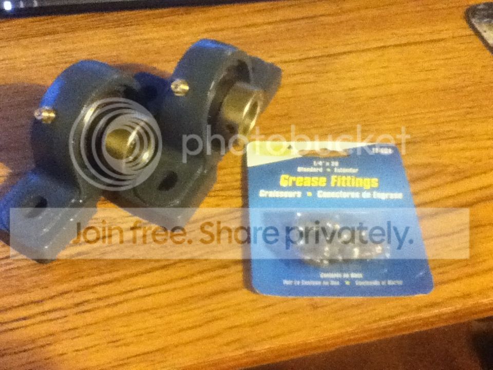

Here's my latest acquisitions for the cause - two pillow blocks an some grease fittings. Just getting stuff fer this as I can afford it.

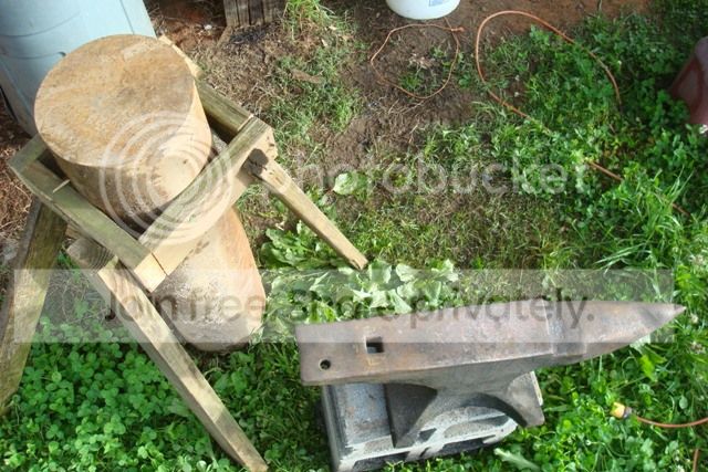

The other night me and Dad got the anvil block unloaded, and to make it easier for moving next time, we decided to leave it upright. Not wanting it to fall on somones toe, I made a frame and braces for it so it'll stay up.
In the pic is my 147 lb anvil for comparison.

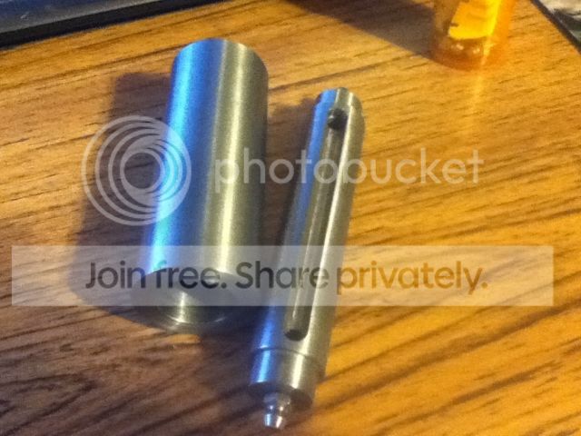

Next pieces checked off the list!

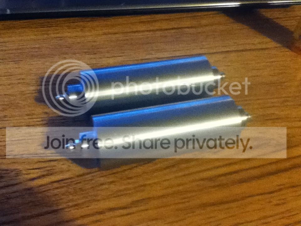

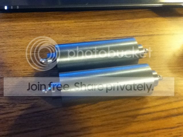

Made up these rollers tonight in the machine shop, these guys will be used on the top of the ram for the helve attachment.
They're based off the design James gave me, zerk fittings on either side, and a trench milled into it to hold the grease, with a drilled hole connecting the two.
