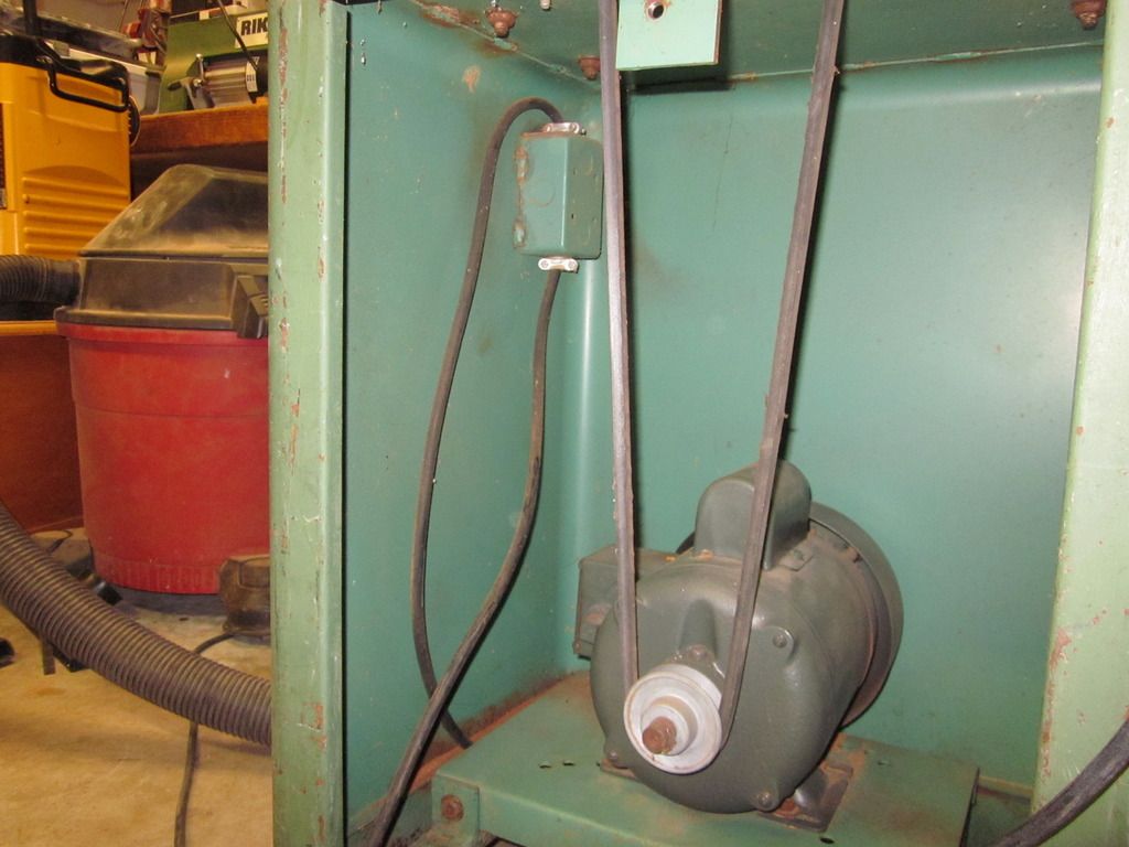

any reason I shouldn't jump all over this buying opportunity for $350?
wood cutting
from the listing
"This bandsaw is of the highest quality construction, with cast iron deck, frame, wheels, etc. and steel body. The wheels have like-new rubber and the saw runs perfectly. Powermatic makes some of the finest woodworking tools in the world, and this is an example of the quality of construction that goes into Powermatic tools.
Comes with 2 blades"

Powermatic builds excellent tools. I don't know anything about prices for used tools so can't help there.
I'd check the tracking mechanism and blade guides real close. The rubber tires on the wheels should be arched instead of flat. It'll track better that way just like a grinder will track better with arched wheels. Blades are expendable, or kinda at least, so don't worry to much about the condition of the blade.

I would buy that if I was you. It is a much better saw than a new RIDGID or Delta, which would cost you significantly more.
I just bought a used 20" Powermatic, also green and with the McMinnville sticker, and it's a wonderful, heavily made saw.
I think Powermatic (the older ones) are some of the best shop-size bandsaws ever made...

i grabbed it yesterday afternoon. The seller is a part time woodworker and just really wasn't using it enough.
He threw in some Brazillian cherry and this piece of ironwood that had been sitting here for 15 years! :-)
