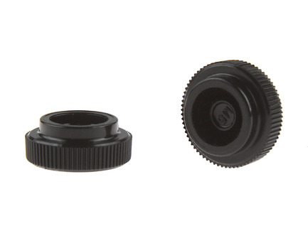

Today I cut out another one and also decided to do these to save some money on thumbscrews. Instead of $8 a piece.
Saved the drawing right from mcmaster carr, Put a hex on the center then save as dxf. Total drawing time, about 30 seconds

These just snap into a SHCS: ugh I hate McMasters website impossible to link to. Search for Plastic Thumb Screw Heads and you get an assortment of different styles.
Ok good. To get the holes for the base mount I grabbed a few different motors from McMaster and put them in a solidworks assembly. Then mated the faces of the motor and made the drawing from that. That's why one of the slots kinda has a weird keyhole shape to it. The thumbscrew I posted a pic of is one of the ones right off McMaster website. The thumbscrews I used on this one are left over from another project. They were free. When I got home from work today I decided to powdercoat the base of the grinder I posted the other day. My heat treat oven isn't big enough so I had to throw it on the BBQ. Here's a shot of the completed table, and also a couple pics of the table articulation. I also got rid of one of the bolt holes for the table arm sliders. It wasn't necessary.
No, if you look at plastic thumbscrew heads, they're inexpensive plastic thumbscrew heads that snap into socket head cap screws. Like this:
Bag of 50 is the price of one or two "thumb screws."
Yeah I've seen those. But I like metal, 2 little tig tacks these will be permanently awesome. Then I can powdercoat them.
Nothing wrong with that. We make those quite often when building fixtures.
