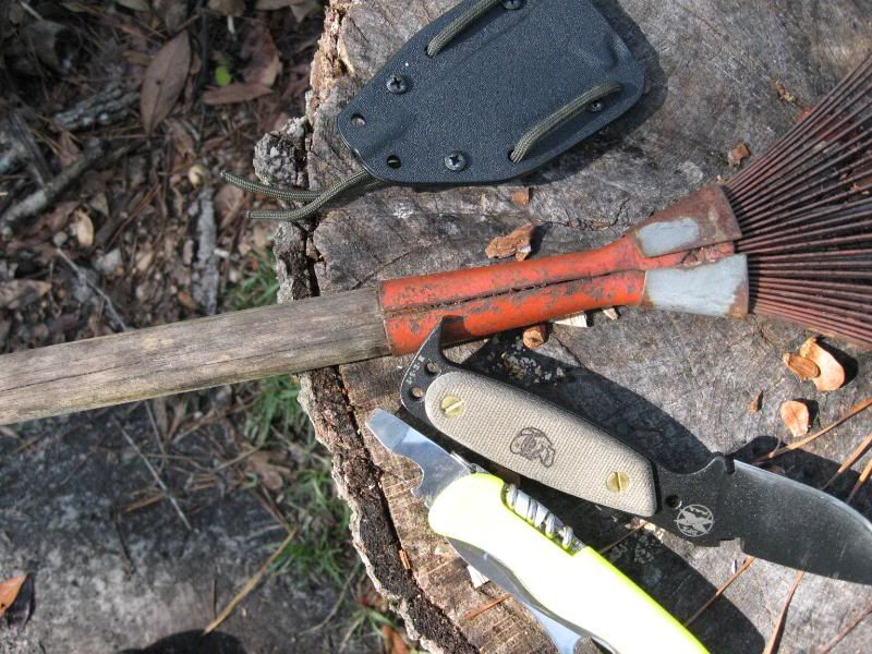

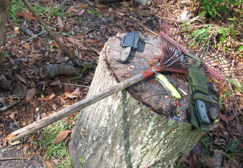

A knife is a tool. All real men love tools. It's what separates us from women and monkeys. Just kidding about the women part. Suppose you were out in the bush and broke the handle on your leaf rake. Ok, maybe a spear or gig or camp shovel. You would need a tool to repair a tool. I was out back on this glorious cool morning and broke my rake handle. It had rotted from me leaving it out in all the rain we had this summer.
I found a nice stick that would make a crooked rustic handle. So which of my knives would serve me best to make a new handle? The first thing I had to do was remove the screw that holds on the old handle. Of all my glorious survival knives I had with me, only one had a screwdriver. The SAK. Too bad the HEST didn't have one. Nope, that prybar pommel just won't work.

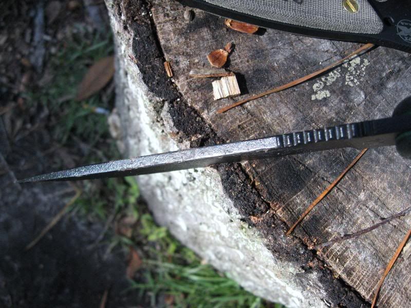

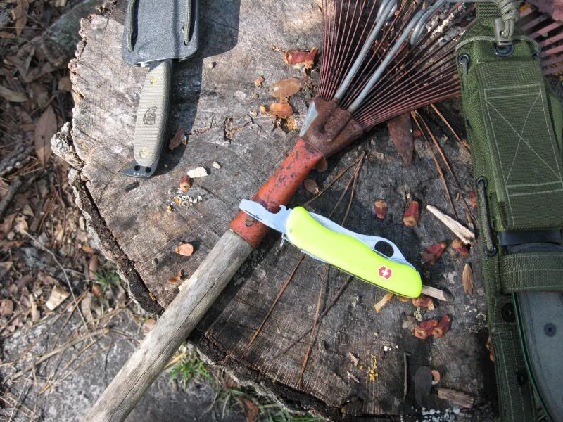

Once I got the screw out, the handle was still too tight to pull out of the socket, so I used the HEST prybar to open the ferrule just a bit. But the screwdriver blade on the SAK worked better. I used the spine of the RC-6 to drive the rake off the handle. I used both the HEST and RC-6 to carve and shape the wood to fit the socket. The RC-6 actually worked better. I just rotated the new wood while "chopping" or scraping with the blade until the profile would fit the rake.

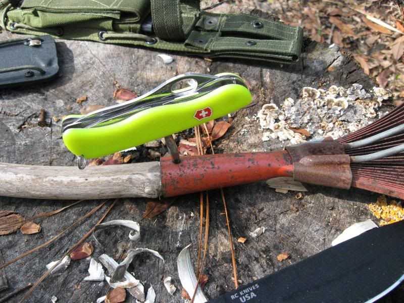

Then I inserted the new handle. I needed to make a starter hole for the screw. I tried the HEST prybar. It sort of worked, but the awl on the SAK worked a lot better.

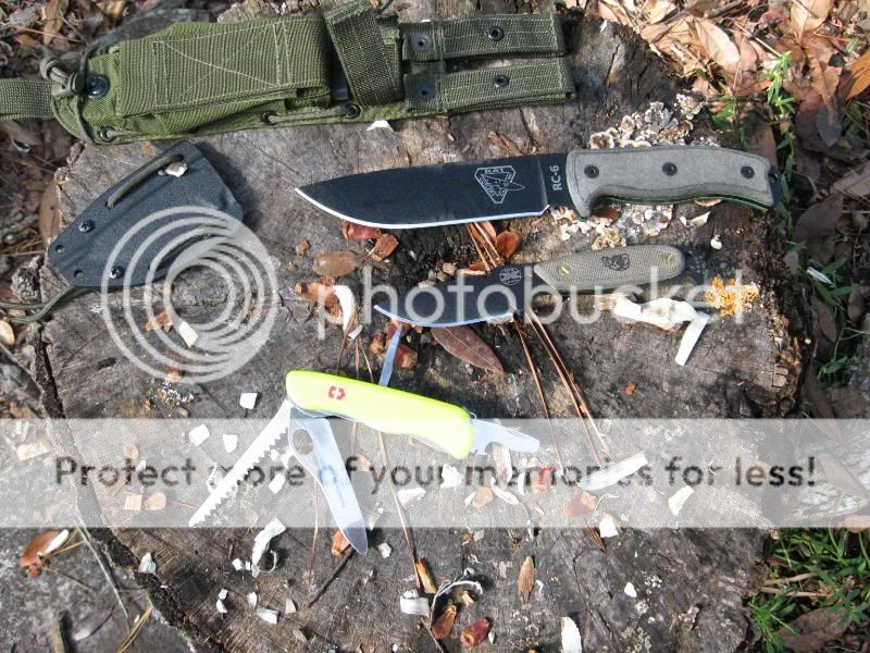

So after replacing the screw with my screwdirver on the SAK, I had a functioning rake again. While all of these knives were useful for some parts of the repair, there was only one that could do the whole job, including sawing the wood handle.
Which is why I always carry a Swiss Army along with whatever fixed blade I might have with me. A good multi-tool in the Spec-Ops sheath pouch for the RD-6 would be another good option. I know I could have easily done this job with normal tools like a drill, screwdriver, pliers and hammer. But I just wanted to see what I could do if I had to do a similar repair in the bush.
