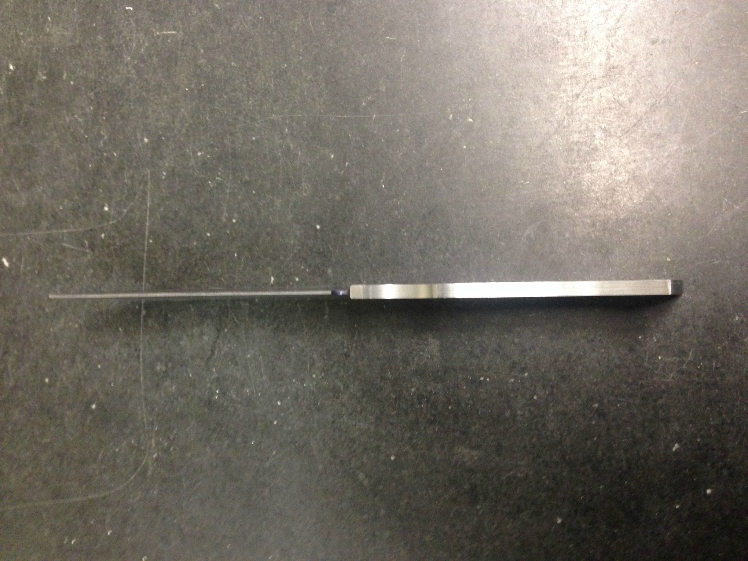

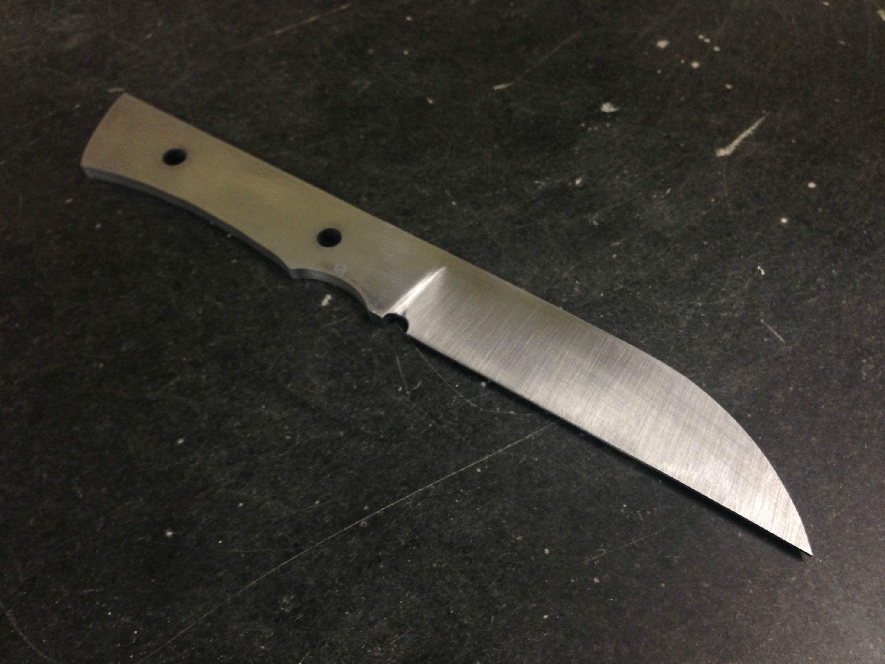

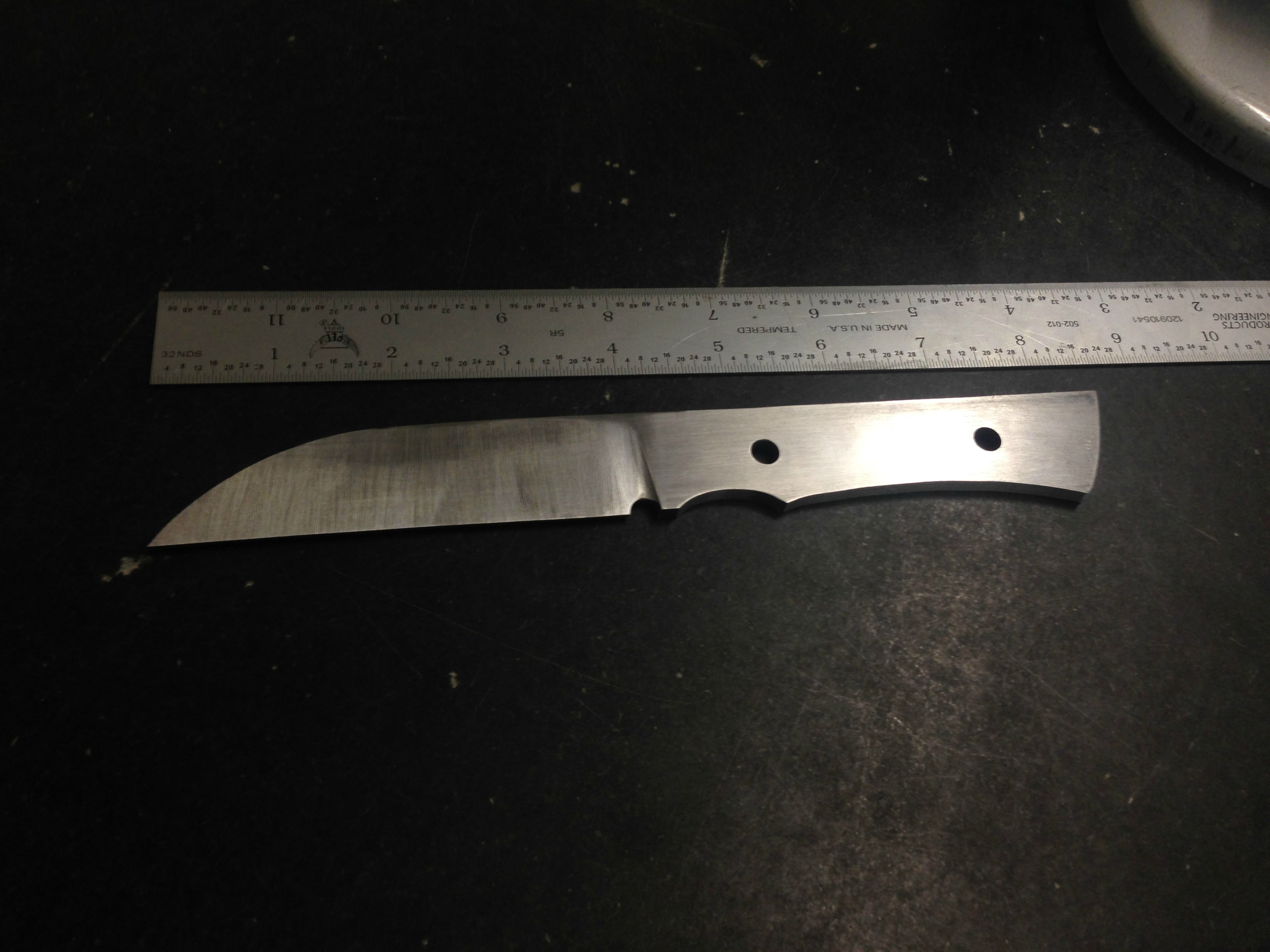

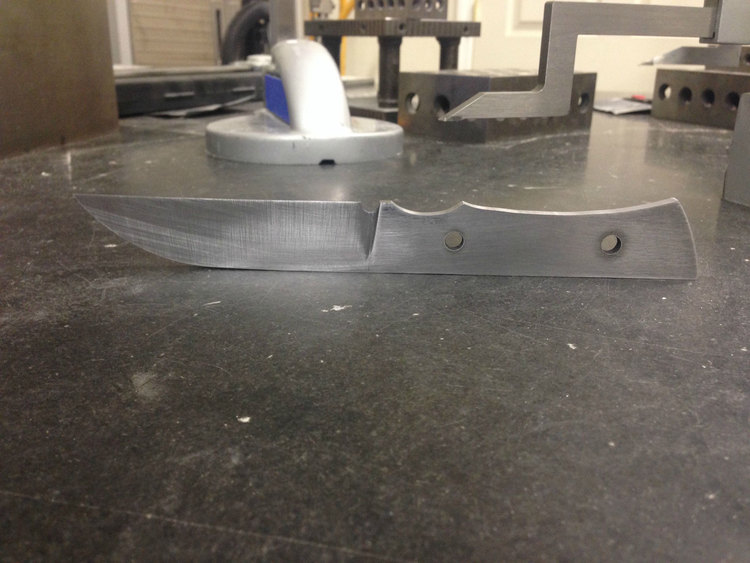

This is the first knife I'll see to completion. Used a Gough file jig to get the bevels. Still having trouble getting perfect plunge lines, although this time I used a chainsaw file to start them which gave me much better results. Was able to get working edge to .025 ± .01, which should suffice for heat treat? I'll be sending off for Darrin Sanders heat treat. I still have to hand rub the finish. I have ferric chloride coming. What grit should I go to in order to get a good acid finish? 220, 400? Anything else I should do before heat treat? Thanks.
def an intersting shape. it looks like the blade got flipped on its spine during the grinding process.

Thats a hell of a good looking knife you got there. Love the wharnies!
