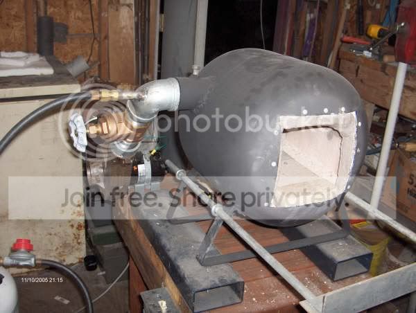

They make great forge shells.
If you cut open ANY old propant tank. make sure youremove the valve, then fill the entire tank with water before you cut or have it cut! IT WILL EXPLODE IF NOT>.
I considered using a tank for a forge at one point in time but its far too dangerous. You can use a 16 gallon drum and get a forge of roughly the same diameter with very little risk.
Forgot to call Agway, on the list of things to do tommorow.
I drilled two 1/2" holes on each side of the valve and purged the tank with a garden hose. One hole was for filling and one for venting. Those valves don't always come off easy.
I drilled them very slowly. You can also get the tanks nitrogen purged to be extra safe. My local feed store charges $3 to do it.
I have never owned a drill with a fast enough speed to create sparks. And even if I did I wold not want to ruin my drill bits by using that speed.
First thing to do, Take the valve off and fill the tank with water. This will force all the remaining propane out the top of the tank. Do not try cutting the tank without purging it first. If you really want to get a little extra protection, Like Brian said, after draining the water run an inert gas into the tank, CO2 or ARGON work well. Then if a spark does occur it cannot burn as there is no O2.
