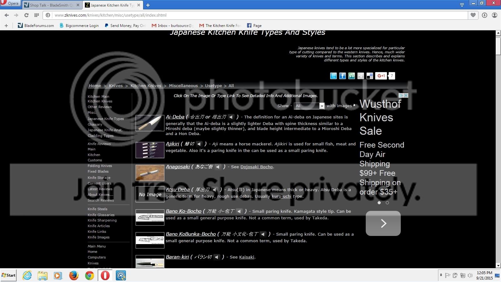

I'm pretty new to forging and am looking for some advice. I can't seem to find enough information on preforms for kitchen knives, and was wondering where I might be able to learn about the different shapes of preforms for different shapes of knives. In particular, I'm looking for yanagiba preform, and scimitar preform.
