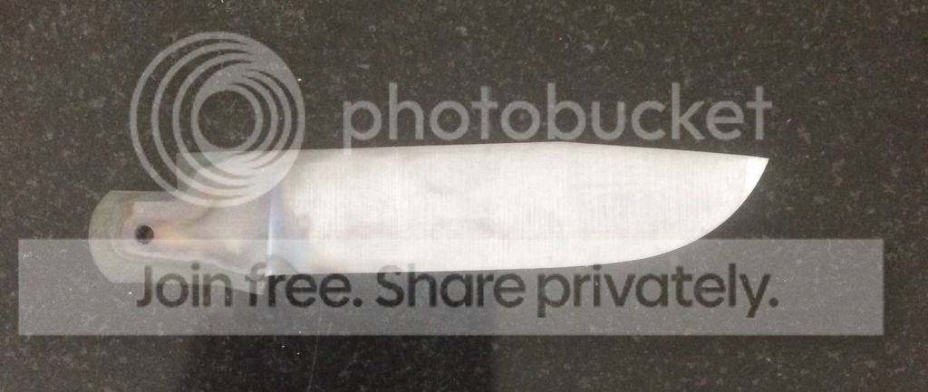

Well here it is after subzero quench.
Looks like a little air got to it in the kiln.
Is this about normal or not?
Calling around today to see if I can get it tested somewhere here in St. Louis
Any builders in this area that might be able to help out?
You will see colours on your blade after heat treat. It's not a big deal. I agree that .03 is much too thick as well

Ok found a lab to do the hardness testing here in St.Louis
Took it to them right after work.
BUMMER!
Came in at 55 to 56
They took three readings along the blade...
Should they of used the tang ? Nice and flat. Plus I sanded the tang smooth while at work today.
Can they get an off reading on a bevel?
Can I reheat treat the blade after it has been tempered?
Anyone got another recipe for CPM 154 3/32 blade?
A real downer !
What I understand with Rockwell testers is that they should be done on a flat surface like the tang or ricasso. Not the bevel.
It needs to be done on a flat surface as Shane stated. I hit them on the grinder so i have fresh steel showing.
Hardness testing can't be done on anything other than a flat, clean surface. Even a tiny bit of surface carbon will show lower results. This has gotten me a couple times. And it really can only be done on the flats. Angles or curves will also throw off the readings and show lower than expected results. I'd bet it's closer to 60+, especially with the lower tempering temps.
Clean off the entire ricasso, get it as flat as possible and then have them retest. I test right above the bevel where my makers mark goes so that the indentation will be hidden by the etch. Or leave it to show proof of hardness testing. Getting it removed entirely is really difficult as the indent is very deep relatively speaking.
