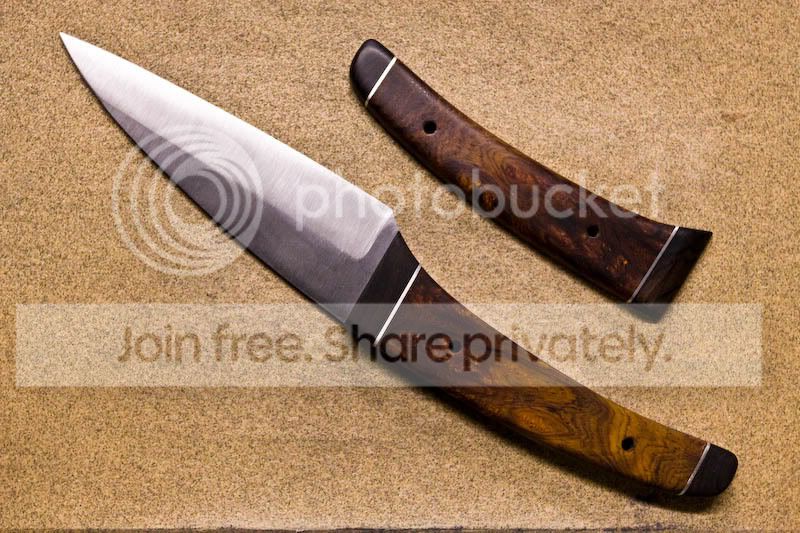

I have never made a knife before. I decided that making a kitchen knife would be an interesting project.
My blade is approaching heat-treat time. I decided to get it professionally done. As this is my first knife, I don't want to get screwed by the heat treatment.
Is there some sort of a checklist to follow to make sure the blade is ready to send off? How fine should I sand? What would a good edge thickness be? I know that the grinds should be symmetrical, and that the blade should be clean. Is there anything else I should know before finishing and sending it off?
The steel is cpm154, and the handles are cocobolo burl, african blackwood, and sterling silver. Having worked on this knife, I have a new appreciation for what goes into a good blade.
Phillip
awesome looking. especially the handle scales. NICE.

Thanks a bunch. I'm at .025 right now; a bit more grinding and I'm ready to finish sand. I think I'll shoot for something between .020 and .015 for the edge.
