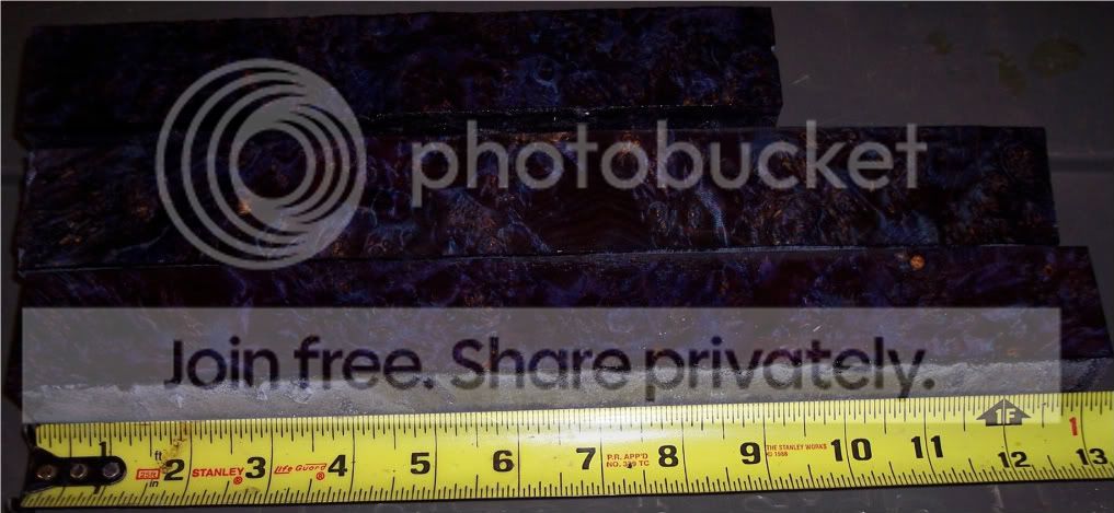

Heres some of my bigger pieces of maple burl in BLUE, as an example....

I appreciate the tips everybody, thanks! In case you wanted to see a pic, here ya go!
