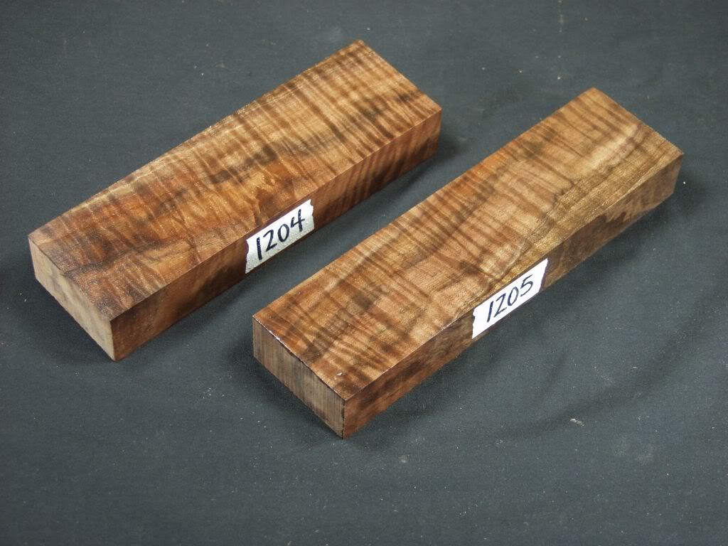

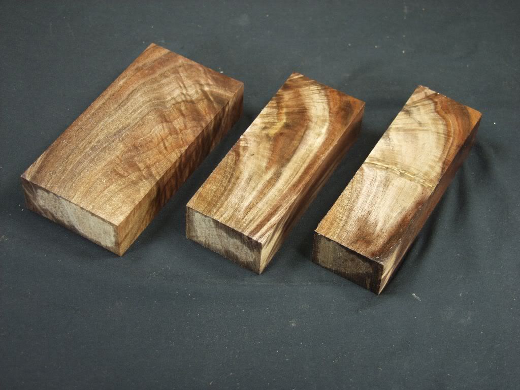

These blocks are some of the best curly figured Walnut I have seen. I am calling them presentation/exhibition grade because the figure covers the entire block and is much more intense than you will normally see in the best figured walnut.
This is natural walnut. It has not been stabilized. I recommend against having it stabilized. Using natural walnut with an oil finish will maximize the chatoyancy, the way the light moves within the figure. The wood has been dampened for the photos so you can get a better idea how it will look finished. Photos show both sides of the blocks.
If you like any of these just post "I'll take #...." in this thread. I will mark it sold and send you a pm for payment. Shipping is $2.50 for 1st class or $5 for Priority mail within the US. If you get 2 or more, US shipping is free.
#1204 SOLD- $30 - 8&1/8" long x 2&1/2" wide x 1&3/16" thick
#1205 SOLD- $30 - 9" long x 2&3/8" wide x 1&3/16" thick
Photo of side A

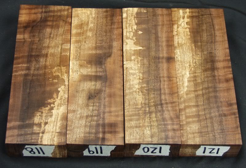

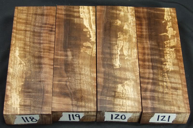

This batch below is just a bit short of being able to be called Exhibition Grade but real close. The spalting also disqualifies them. These pieces are cut quartersawn so the colors caused by the spalting are almost the same on both faces. Since the spalted (light colored) areas are softer you will need to stabilize these or use a wood hardener.
Spalted Curly Figured California Walnut Batch
#118 - $20 - 7&1/2" long x 2&1/2" wide x 1&1/8" thick
#119 - $20 - 7&1/4" long x 2&3/8" wide x 1&1/8" thick
#120 - $20 - 7&1/4" long x 2&1/4" wide x 1&1/8" thick
#121 - $20 - 7&1/4" long x 2&1/2" wide x 1&1/8" thick
Photo Side A - Spalted Curly Figured California Walnut Batch
Photo Side B - Spalted Curly Figured California Walnut Batch

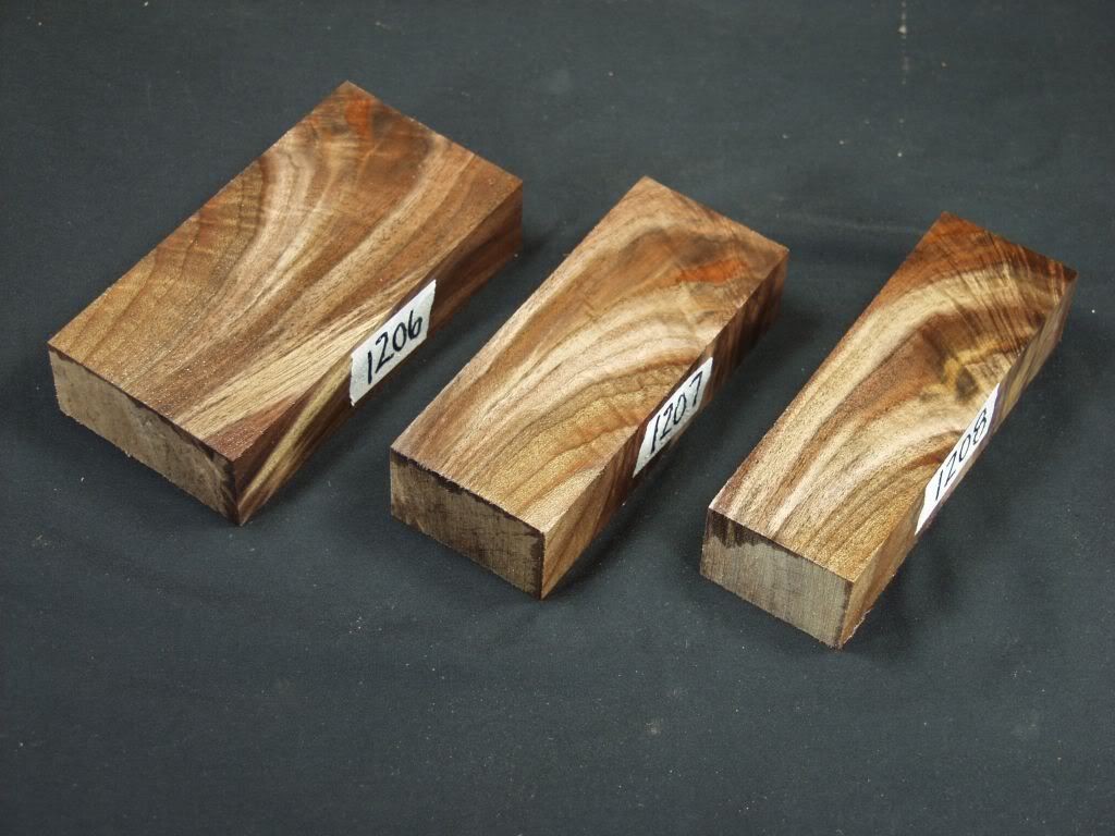

I cut these blocks special to be used for larger knives with a flared butt. These were cut from the crotch section where the grain curves and flares outward. There is nice figure in these blocks. It will be more predominant in the butt end.
#1206 SOLD- $20 - 5&3/4" long x 2&7/8" wide x 1&3/16" thick
#1207 SOLD- $15 - 5&1/2" long x 2&1/8" wide x 1&1/4" thick
#1208 SOLD- $15 - 5&7/8" long x 1&7/8" wide x 1&1/4" thick
Photo of side A
Photo of side B

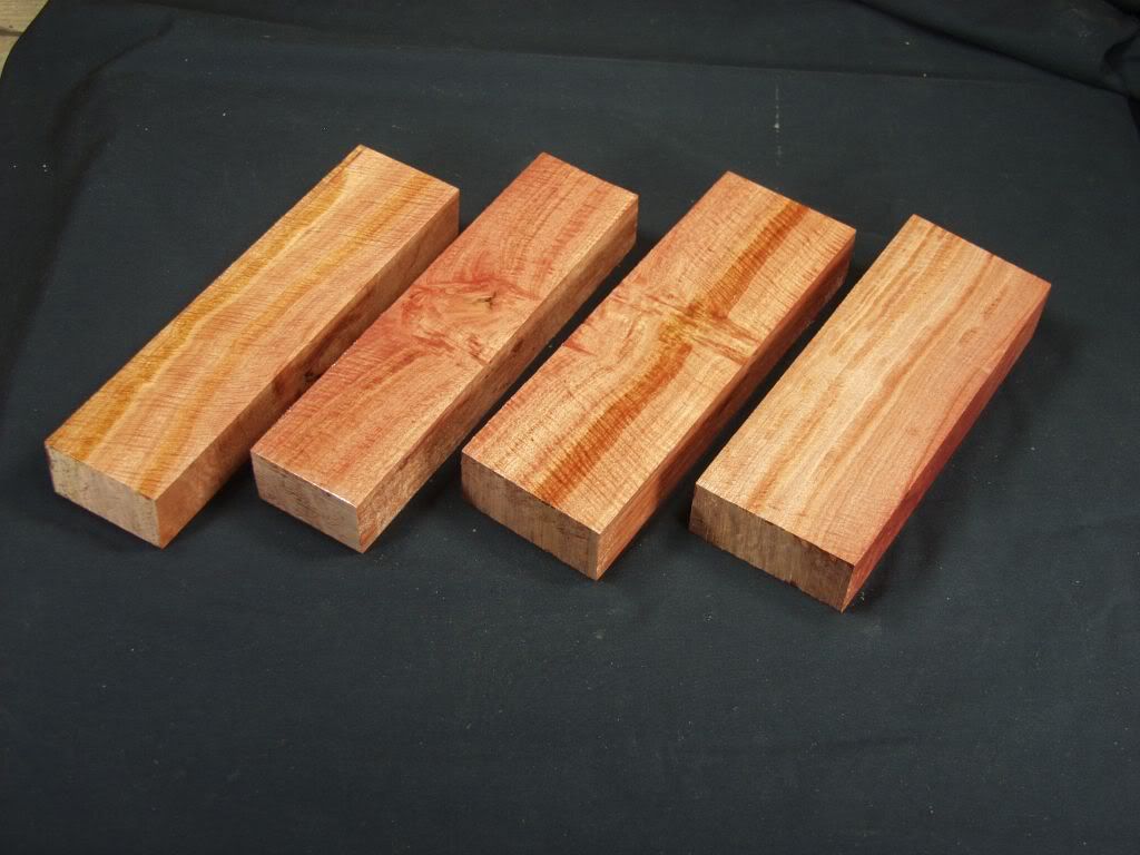

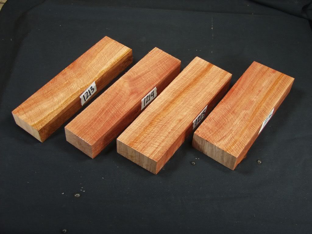

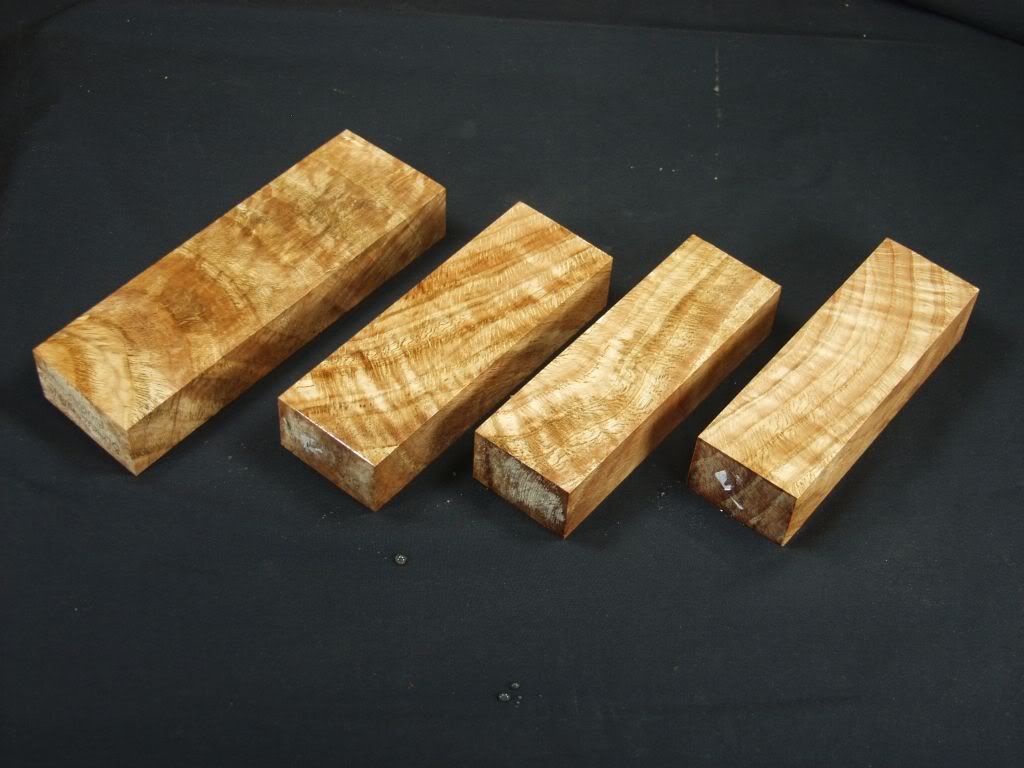

These blocks have some of the most compact figuring that you will see in any figured wood. The wood is California Red Gum Eucalyptus that was cut quartersawn to maximize the tight fiddleback figure. Eucalyptus is a very hard wood that works great for knife handles. The wood gets darker when you fine sand and polish it. Some wood turners use this as a substitute for Pink Ivory wood.
This is natural eucalyptus. It has not been stabilized. Using natural eucalyptus with an oil finish will darken the color and maximize the chatoyancy, the way the light moves within the figure. The wood has been dampened for the photos so you can get a better idea how it will look finished. Photos show both sides of the blocks.
Prices on these blocks have been lowered for a short time.
#1213 - Sale $15 was $25 - 8&1/2" long x 2&1/8" wide x 1&1/8" thick
#1214 - Sale $15 was $25 - 8&5/8" long x 2" wide x 1&3/16" thick
#1215 - Sale $20 was $30 - 8&5/8" long x 2&3/8" wide x 1&3/16" thick
#1216 - Sale $20 was $30 - 7&1/2" long x 2&3/4" wide x 1&3/16" thick
Photo of side A
Photo of side B

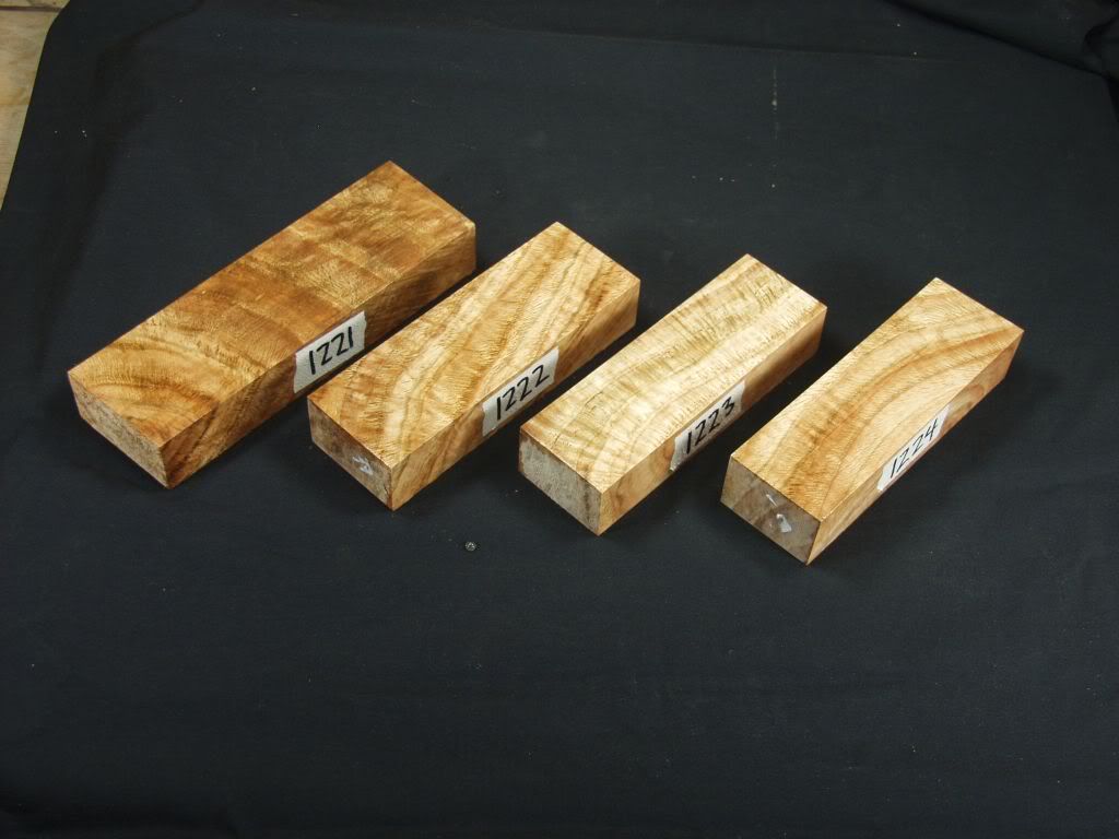

These blocks were cut from a bunion type burl. Most burl is pin burl which will have eyes in the figure. A bunion burl is more of a mutated growth on the side of a tree like a beachball stuck to the trunk. Instead of eyes, the figure is more like reflective shimmer with unusual grain patterns and coloring. The wood type is Oregon Black Oak. A member of the red oak family with unusual coloring and more compact, closed grain.
This is natural oak. It has not been stabilized. The wood has been dampened for the photos so you can get a better idea how it will look finished. Photos show both sides of the blocks.
#1221 SOLD to fishface5- Sale $18 was $25 - 7&3/8" long x 2&3/8" wide x 1&1/8" thick
#1222 SOLD to fishface5- Sale $15 was $20 - 6" long x 2" wide x 1&3/16" thick
#1223 - Sale $15 was $20 - 5&7/8" long x 1&7/8" wide x 1&3/16" thick
#1224 - Sale $15 was $20 - 5&7/8" long x 1&7/8" wide x 1&1/4" thick
Photo of side A
Photo of side B
