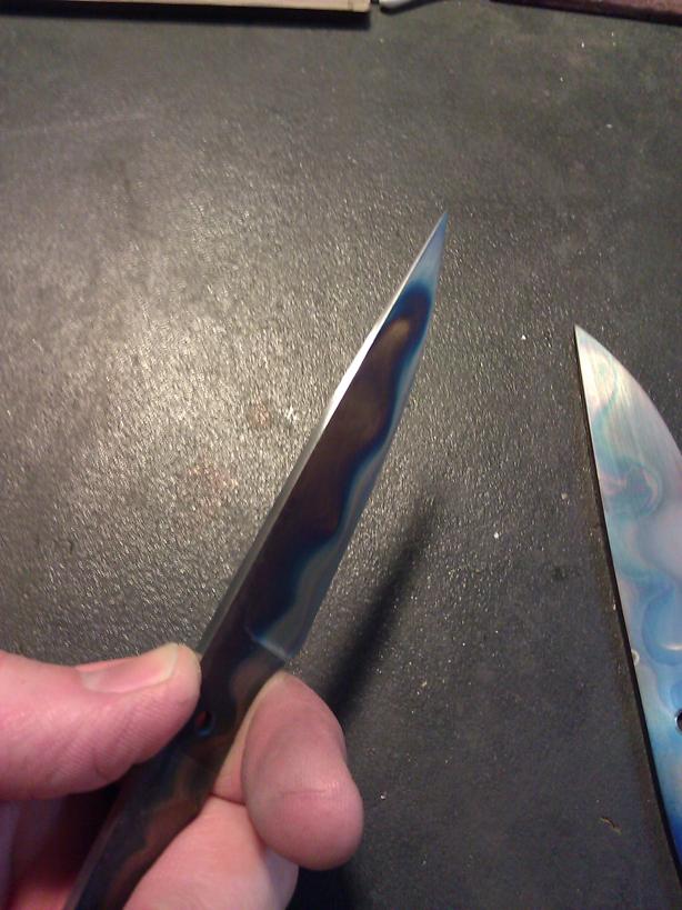

Hi O Knowledgeable Crowd,
I have this pair of A2 knives that I was preparing to polish in prep for handles.
But the heat-treat patterns are so damn pretty...
I started to polish the perimeter of the paring knife first, as is my routine, and rather than looking goofy as expected, the contrast between the shiny rounded spine and the crazy colored flats stopped me in my tracks!
Question is this:
Is it possible to keep this? Just tape up and go to handles?
How hard is this surface oxidation? I couldn't scratch it off with the end of a brass tube.
Does it provide any corrosion resistance? Will the knife just patina in time and then look crappy, like a war in a petri dish?
I only sanded these to 360 before heat, as usual. If I'd planned on keeping it I'd have gone one more step to 600...
I'm leaning toward sucking it up and polishing them to 1000 like normal, and then trying this again in a more planned fashion, depending on the sort of information that bubbles up here.
-Daizee
(pardon the blurry pictures, not enough light, and flourescent...)

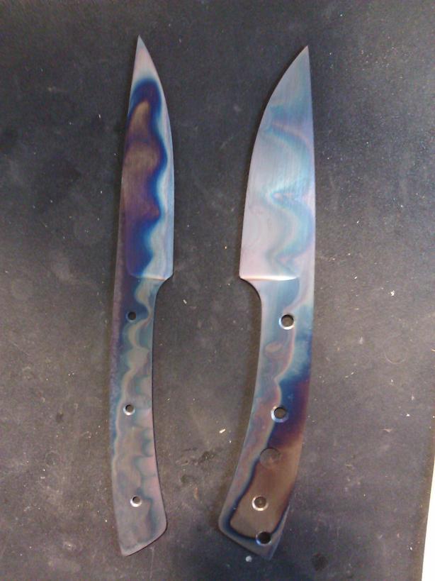

Why not do something like cord wrap the handle or just put some cheap wood on a rough shape and cut up a bunch of stuff and see how it holds up. It is a pretty thin layer so might not do well in use. Also, if your going for the finer finishes with a air hardening why not go to the finer grits pre HT. I now go all the way to an a30 (800 grit) belt pre HT on my D2. Stuff just sucks to sand after it is hardened
I would sand it off. It isn't of any benefit, and there is a thin layer of decarb steel that needs to be removed. It won't last anyway.
Would you leave the primer on a car you were restoring because it looked COOL...or paint it with five coats of lacquer and make it really look good? If you were buying that car, which one would you want?
If you are going for that look, you can polish them out and then run another draw cycle. You should get a color pattern similar to that.
Hmm, alright. Thanks, Everyone.
For this pair I'm going to polish them out.
But perhaps there will be a low-risk future experiment. maybe 600-1000 pre-heat, then JBS's idea, then wax the snot out of it.
-Daizee

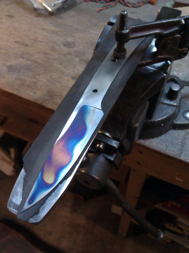

The difference between these 'dashis and the paring/hiking pair at the top is that the dashis have cleaned bevels (on a stone by hand), whereas the other blades would have had the bevel surfaces left colored and prone to scratch-up. I think this might be a good configuration since the pretty colors won't be covered with scales.
I waxed them several times with Flitz Rifle & Gun wax, as with most of my blades. It's hard to say how well it took, but the kydex sheath on the larger one hasn't rubbed anything off yet. The larger one has a fairly coarse 220g finish, and the little guy is somewhat smoother. I'll post an update as they age.
-Daizee
Bye-bye, Pretty Colors...
(daamn, it looks cool half-polished too!)
