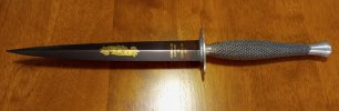

Given the amount of experience on this forum, I would like to request advice on how to best proceed with a Marine Raider Stiletto that has quite a bit of surface rust and a blunted tip, but is otherwise a nice specimen. This knife came to me in this condition and was clearly stored in the original sheath for decades given the rust pattern.
I know that it is generally not advised to remove patina from antique knives or to sharpen/reshape/re-tip blades. However, rust is the enemy of carbon steel blades and will continue to degrade the blade. Would it be advisable to use Metal Glo, Brasso, Googone, or WD-40 to remove the rust? If not these, then what?

I cleaned-up a knife last year and had real good luck with 3-IN-ONE oil.
For the life of me, I can't recall what I used to scrub, but it was either a Scotch Brite or copper scrubber.

I flatten a rifle cartridge and use it as a scraper to knock the rust blumes off. Do it dry so the abrasive rust dust falls away.
Blow it off with compressed air, or even the exhaust port from a shop vac.
Then oil it and rub it with a rag.
This method even works on blued guns. The brass is too soft to scratch the bluing.

depending on how much rust...a pencil type eraser will clean up smaller amounts of rust without marking up the blade and finish.....wont do well at all on massive rusting though....
The eraser scares me, but as stated it should be fine on a small rust spot. the rust is very abrasive and could become imbedded in the rubber. Thats why I don’t use an oily rag, until the rust is removed.
Some people recommend using a pencil, I haven’t tried it, but see no reason it won’t work.

I have used scotchbrite pads in various grits pads to very nicely clean carbon steel blades. I usually prefer the finer pads to the coarse pads but they do a great job cleaning up a blade.
I have done this to a M1 bayonet cut down to a fighting knife from wwii that was carried by and I inherited from my grandpa that was in a similar condition.
If the value is purely sentimental, do what you can to stop future damage and preserve it.

We need to see pictures of the actual blade-otherwise we are just guessing at methods.
As someone who professionally restores knives, I can tell you NOT to use Scotchbrite pads or anything abrasive.
The safest thing to use on your blade is WD 40 or WD 40 specialist. Neither will remove all of the rust, though.
