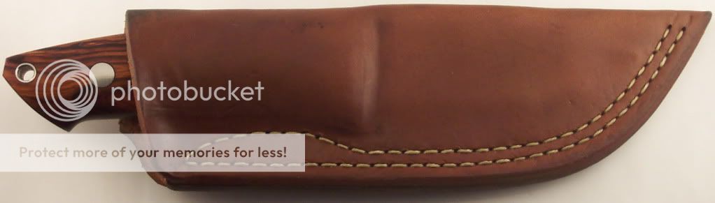

Hi Fellas:

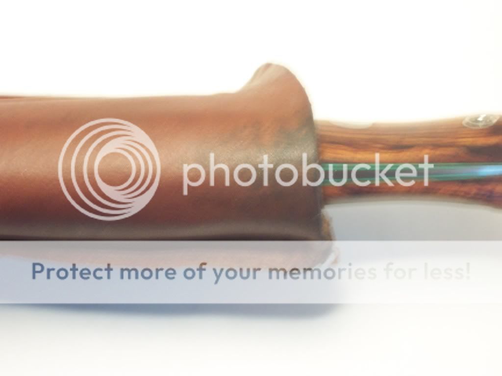

Here's a Loveless Dropped Hunter I just completed for a customer. I have a recurring problem with stains showing up on the sheaths. I like to use natural vegetable tanned leather and neadsfoot oil which gets the color I like. I use warm tap water to mold the sheath, with clean hands or rubber gloves, and leave the sheath on a clean surface while working it. I usually end up with dark stains somewhere on the sheath - see picture of my most recent sheath complete with a stain. There's a rather large one near the hilt area and another stain on the front. This has happened to me many times on many sheaths.
I've tried using acetone to remove them - no dice. I've used rubber gloves - no dice. Are these mineral stains from the hard water? Does using distilled water make a difference? Or is there a product I should wet the sheath with prior to working it? Any suggestions to prevent these "phantom stains" from surfacing would help greatly. I don't like the idea of using leather stains to cover an existing stain......I'd rather prevent the stain from starting in the first place.

I think I know what that stain is - I think it steel getting on your leather while wet.
I know that steel will make your leather turn black (even in little amounts) while wet. Do you work on your leather on another bench that you might cut steel on?

High Iron content in the water "might" be part of the problem but it should be more uniform over the sheath if it is. Metal, steel in particular will stain leather badly if wet, Drive a blue steel tack in a wet scrap and observe. Wetting the leather at different intervals can produce water spotting, but not stains as you have shown. If you are using anything with metal on it to do the boning when wet forming, that could be it.
Next, if you are getting a side of leather @25 sq ft for $100, I would bet you are getting import leather and the tanning process is vastly different from good old USA sides. The quality of the hides is in my opinion less as well. This could well be the source of your problem if the tanning chemicals are not flushed and rinsed completely which is often the case with import leather. I keep remembering that old saying....."if you start with sh*t, it will probably still resemble sh*t when you are finished". Another one I like is "The most expensive leather you can work with is the cheapest leather you can find". After you figure in the waste from crappy results and the time wasted from "do overs" a bargain pice of leather may not look like such a bargain after all.
Having said all of that, you can minimize those stains with Oxalic Acid (wood bleach). Tandy/Leather Factory, Lumber yards, Lowes, Home Depot etc. It is POISON so use caution.
