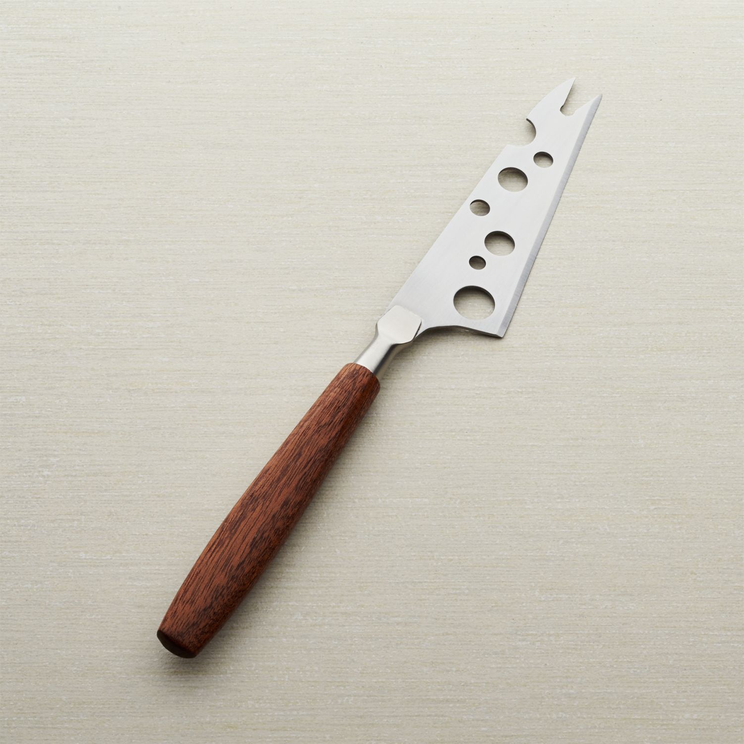

Cheese knives have holes in the blade to prevent sticking -
MahoganyHandleCheeseKnifeSHS16
I have a Cutco cheese knife and it works really well on things that stick -
Just a thought - not a bladesmith here at all - just a user.
