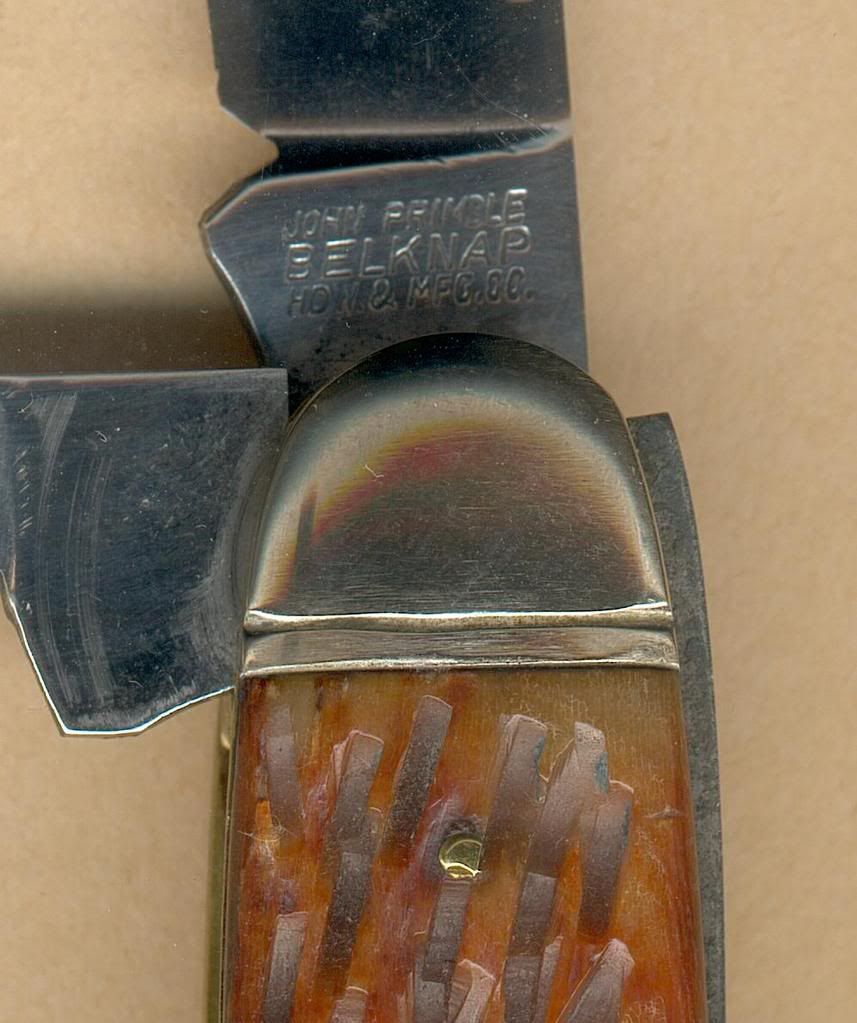

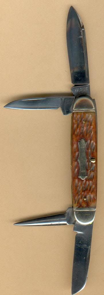

Someone suggested to me that Schrade may have made this knife. Its a 4-blade Cattle knife, with oddly jigged bone handles, and is stamped; JOHN PRIMBLE over BELKNAP over hdw.&mfg.co.
If there's anyone out there:rolleyes: , maybe someone knows about the maker, and/or the bone jigging? Thanks,
Charlie
My opinion....
Definitely not a Schrade, at least none of the details (tooling, blade grinds, pulls, bone) look like Schrade to me.
Hard to place but a guess would be BOKER USA, possibly Camillus....but would have been pre-WWII knife from either of them since neither showed that pattern in their post-WWII catalogs.
Very nice piece BTW. Some of these contract knives can be tough to figure out.
Based on my observations, BOKER USA made probably 90% of the post-WWII Primble knives, with the balance made by Schrade and Ulster (part of Schrade by then).
I don't know about the jigging, and cannot match the exact pattern to a particular Schrade, however the blades individually do match rather closely the ones illustrated in the early Schrade Cut Co catalogs, as does the shield. Schrade called it a "cattleman's" or "Empire" shield at various times. Don't rule out an Ulster origin, however. After 1946, Schrade sold both knives, as well as a few Imperials to Belknap. Perhaps someone with the complete older Belknap catalogs can match it exactly. Belknap was sometimes good about including alpha or numeric cues in their model numbers indicating the origin. Also, other makers did make knives for Belknap, and those blade and shield designs were not entirely unique.

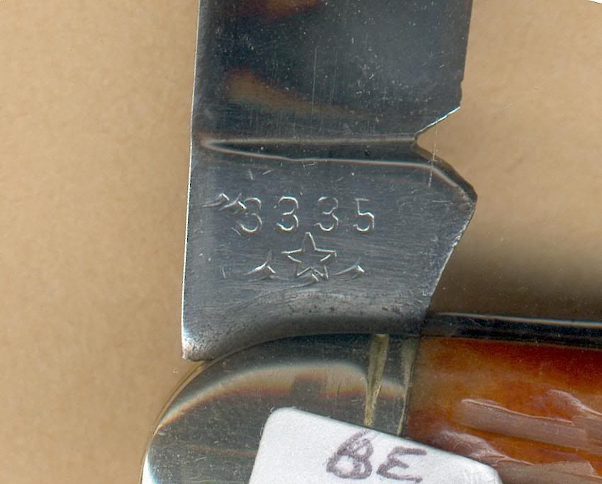

Thanks Knifeaholic, and Codger, and accept my apologies, I forgot to include the rear marking on the main blade.
It is stamped; 3335 over a 5 pointed star.
Ka-Bar used a five pointed star to indicate stainless steel 1962-64, but this knife appears older. There was a Star Safety Razor Corp post 1915, formerly Kampfe Bros. These are the only five pointed star stamps I see in Goins.
Most likely Boker then....every Primble that I have ever seen that I can trace to Boker via the tooling, has had the star.

Here's a shot of the back tang, for everyone's info. Does this confirm anyone's recollections??
it's lot older than when kutmaster (utica) made them
but in the 70's and early 80's it was kutmaster
