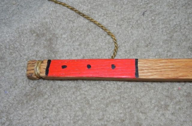

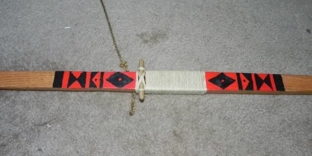

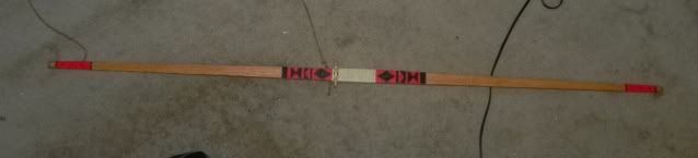

Finished another bow today. This is a light (37lb) target for RescueRiley here on Bladeforums. The bow has no stack at all and took only 3/4in of set after 50 shots at full draw. I'm hoping that after it is fully broken in, it will have less that 1.25in.

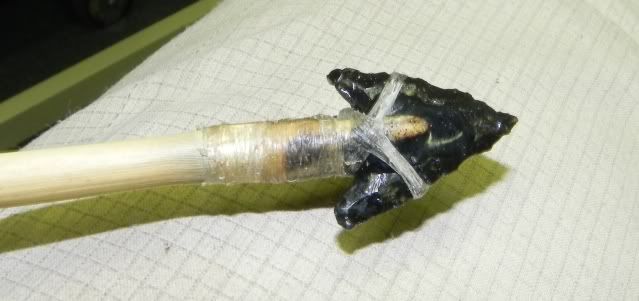

I also hafted this knapped head for a friend with pine pitch and deer sinew.
