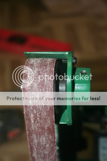

I bought a new HF 1x30 grinder for 32 bucks w/ the 20 percent off coupon today.
I was very excited, but when I got home, sadly, the belt wont track correctly, and the platen was off center. :(
Im gonna take it back to the store and ask for a replacement.
Heres some pics:
This is the best I could get it to track. Its not horrible, but I still want it flush, after all I payed expecting a non-defective grinder. The tension bar is twisted all the way, If I dont, half the belt would be off the side and half on the wheel. Here are some various angles:
As you can see, the bar is all the way:
The platen cant line up. Its exactly 90 degrees to the side of the machine, just doesn't line up. I used a tri-square to ensure that it is 90 degrees from the side of the machine. The belt rides perfectly flat on it and smoothly, just it isn't lined up.
Anybody get the same thing? Anybody have experience with HF customer service?

The tracking issue is just how they are in my experience. 1/3 of my belts are too tight to run and 1/3 will fly off with a little pressure no matter how I adjust. That said, I really like it, but I take it at face value.
The platen problem is just the design. It wasn't meant to be precise and adjustable. Just cheap. You could probably glue a wider piece of steel to it as a quick solution.

Don't worry about where it tracks on the idler wheel, you're not grinding up there. BTW, it's the best I've ever seen one of those track too. I doubt you'll get anything better if you exchange it, probably worse. The only place that matters is on your platen, you will need to make a new platen or modify that one to make it right. I would be really careful trying to sharpen a scandi grind with this one. It runs really fast and moves around a lot. DON'T try it on a knife you like first...
The platen is just sheet metal..Bend it back where you want it.....Mine has been in use for 10 years, still going strong.....Seeing little use, but good for some polishing...But watch for heat buildup.........carl

Try wrapping the idler with tape to correct the tracking problem.
The platen can be straightened with a shim (think "washer.")

Don't suppose wrapping a single piece of celophane tape around one side of that upper wheel would help?
I'm sure you've checked this, but since no one else has asked, I'll throw it out there. Have you tried multiple belts to make sure it's the grinder and not the belt? Occasionally I get a belt that just won't track. If you turn the belt around and it still tracks the same way, it's the grinder, but if it runs off in the opposite direction, it's the belt.

looking at your next to the last pict , it looks like you have enuff adjustment to straighten it out and make it inline with the belt... that original platen still sucks though.
Try two wraps of electrical tape around the idler wheel on the side the belt wants to wander off.....
